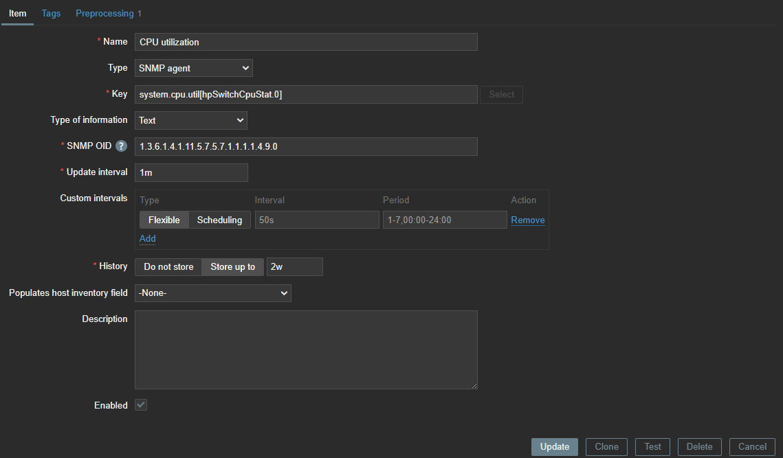

    I am monitoring 14 HPE 1920 OfficeConnect SW, based on HP Enterprise Switch by SNMP​ template.
    The CPU Utilization OID is not correct. after long search I have found the right one, the problem is the value i get is pretty long
    snmpwalk -v2c -c XX 192.168.6.6 1.3.6.1.4.1.11.5.7.5.7.1.1.1.1.4.9
    iso.3.6.1.4.1.11.5.7.5.7.1.1.1.1.4.9.0 = STRING: "    5 Secs (  6.7004%)   60 Secs (  8.776%)  300 Secs (  7.8696%)"
    There is a way to break it down and get only part of the outcome?
    In addition I would like to duplicate the HP Enterprise Switch by SNMP, when I try to do that, it just changing the name of the current one instead of duplicating it, any idea?
    Thank you
    Preprocessing... regex. "5 Secs \(\s*(.*)%\) 60 Secs \(\s*(.*)%\) 300 Secs \(\s*(.*)%\)" and return value either \1 or \2 or \3, depending on what number you want to save...

      Thanks cyber
      ***Removing the value and execute fixed the problem***
      When i test the value with the regex, i get the right result.
      but when running i get this error:
      Preprocessing failed for: 5 Secs ( 7.6393%) 60 Secs ( 7.6944%) 300 Secs ( 7.7524%)
      1. Failed: cannot perform regular expression "5 Secs \(\s*(.*)%\) 60 Secs \(\s*(.*)%\) 300 Secs \(\s*(.*)%\)" match for value of type "string": pattern does not match
      Click image for larger version  Name:	image.png Views:	0 Size:	19.9 KB ID:	458121​
      Any idea?​

        What's your item type? Set item type to numeric(float) . you need to set it to the value, what is going to be saved.

          Hello, I am trying to make this work but without success...I am getting the following error: Preprocessing failed for: 5 Secs ( 22.1128%) 60 Secs ( 24.9054%) 300 Secs ( 24.6851%)
          1. Failed: cannot perform regular expression "5 Secs \(\s*(.*)%\) 60 Secs \(\s*(.*)%\) 300 Secs \(\s*(.*)%\)" match for value of type "none": pattern does not match
          I set the item type to numeric(float)

            Try this:
            5 Secs \( \s*(.*)%\) 60 Secs \( \s*(.*)%\) 300 Secs \( \s*(.*)%\)
            \3%
            for the first one keep the space at the start
