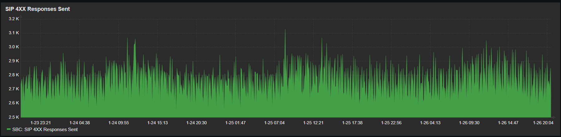

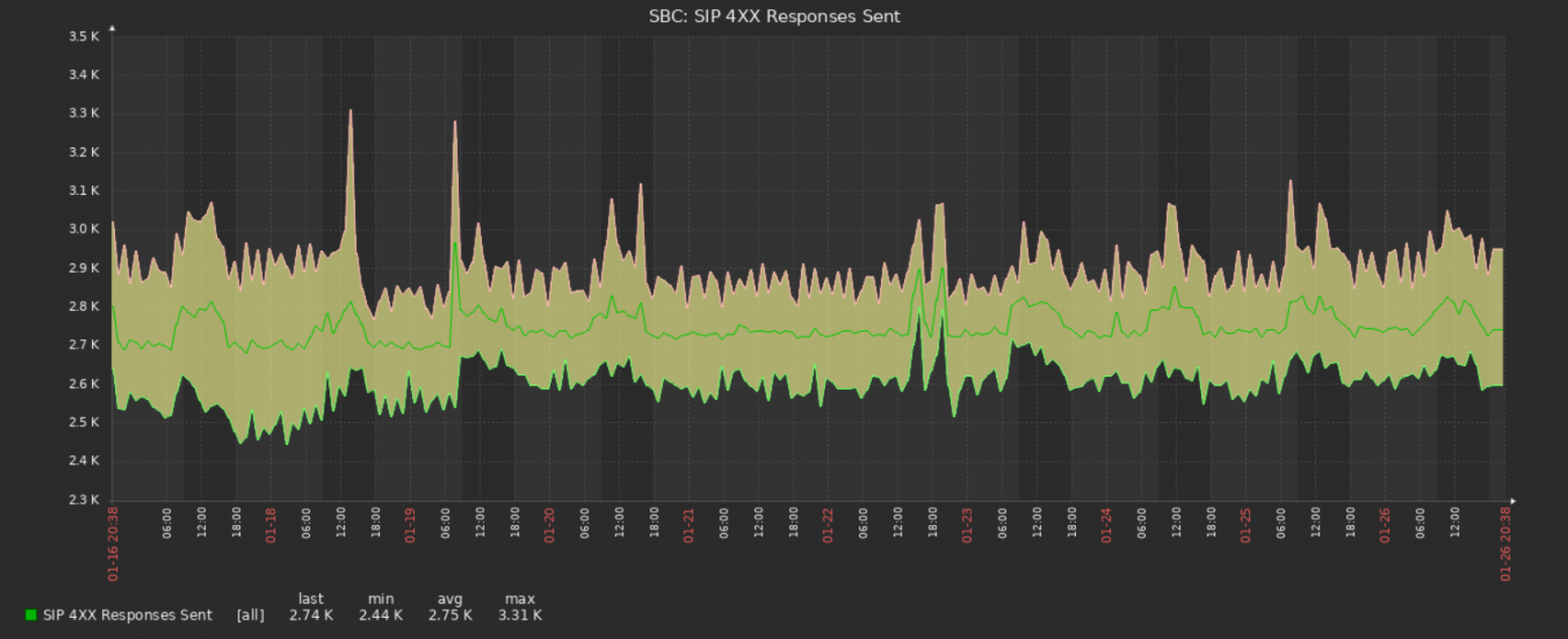

    I am trying to create screens/slideshows in Zabbix, which I have succeeded in doing. However, the colors or my graphs are all screwed up on the screens page vs the graph that you see on my dashboard. See attached pictures for a visual of what I am referring to. There are no graph edit options on the screens page. The nice green on is the way that it is supposed to look on the screens page.
    Screens are dead anyway... but here is a case of what is used to draw that graph... history vs trends. Green one is from history, yellow from trends. You can see min and max values for certain data point (1h period) and green line there represents average.
    Green graph is for data ~3 days, as I see... and other one is about 10 days... How long you keep you data? Let me guess... 7 days? So you cannot draw 10 day graph without trends.. Reduce timeframe to what you have as history and that graph may turn "green" also.
