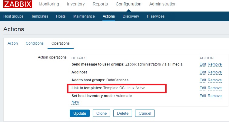

                      I am following exactly as mentioned. Still I see hosts are getting added without templates assigned to it. I have attached image for my action under zabbix for your reference.
                        I understand however if you have registered host without templates it means that you have probably other action with overlapping conditions.
                        So as I wrote you should have look on you list of actions and check other actions conditions
                        • PratapSingh
                          • Apr 2016
                          • 29
                          If I understood correctly for each action I have to assign an unique template. Is that correct understanding or am I again wrong. I have assigned template name ->"Template OS Linux Active" to multiple actions. I have to create unique new(cloned) template for each and every new action.
                          • kloczek
                            • Jun 2006
                            • 1771
                            Nope. Each unique set of action conditions can assign even the same template(s).
                            For example you may have few groups of hosts working under Linux but with different applications so every of such actions will be adding use OS Linux specific template and second template(s) with monitoring exact application(s).
                            One action per host or group of hosts doing the same things.
                            You don't need to clone anything as long as you are using exactly the same set of metrics.
                            Cloning is to make initial copy of some template if you are going to add some changes in new variant of well known template or if you are going to start working on next version of the templates.
                            It is another way to deal with some common and variable parts of some templates.
                            If your A template has for example some set of triggers which are using some macros you can create A1 template inheriting A template with changed values of macros or new triggers which should be used on some exact set of systems. In such case any change made in A template will be automatically propagated to A1 template as well. So here you have typical inheritance mechanism.
