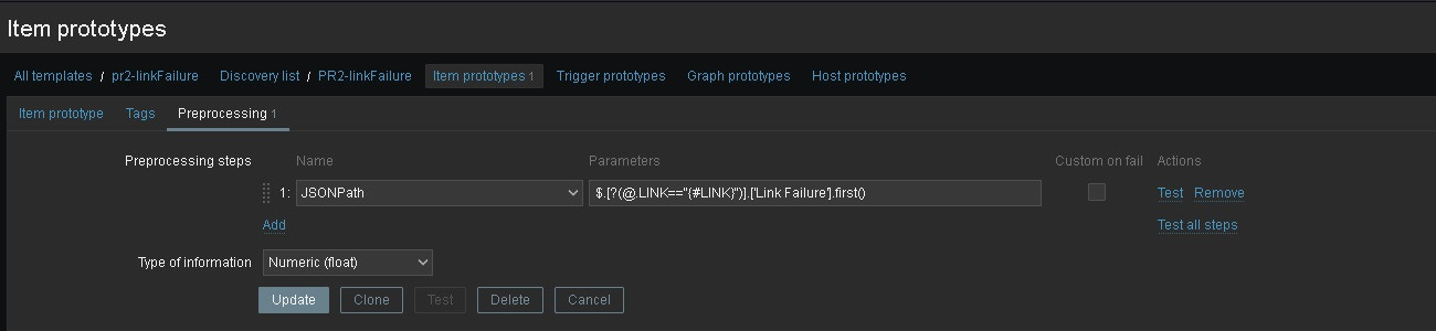

    and I set preprocessing such as attached pic but it does not work and I think relates to preprocessing JSON path . what is the issue ?
    It is showing follow error :
    HTML Code:
    Preprocessing failed for: [{"Timestamp":"2023-02-08 15:05:00","SP":"spa","LINK":"spa_fc4","Link Failure ":"1.000"},{"Timest...
    1. Failed: cannot extract value from json by path "$.[?(@.LINK=="spa_fc4")].['Link Failure'].first()": no data matches the specified path​

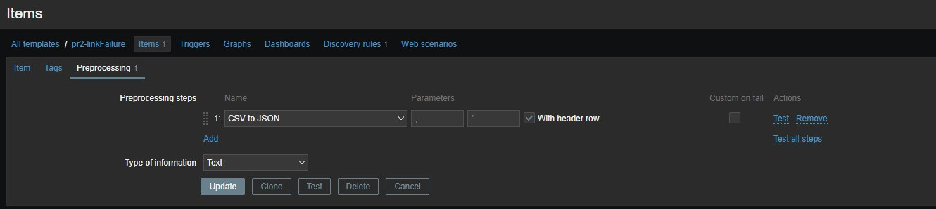

    You're doing JSONPath pre-processing on the CSV output. First do pre-processing "CSV to JSON", then use that output to do the above mentioned JSONPath pre-processing.

      I have defined it previously in items such as attached pic . According to error it is showing JSON path is not correct . I think we have to change in json path .

        I've tried your steps in my environment and they worked just fine. I got the final output "1.000". There must be some other error which you'll have to investigate.

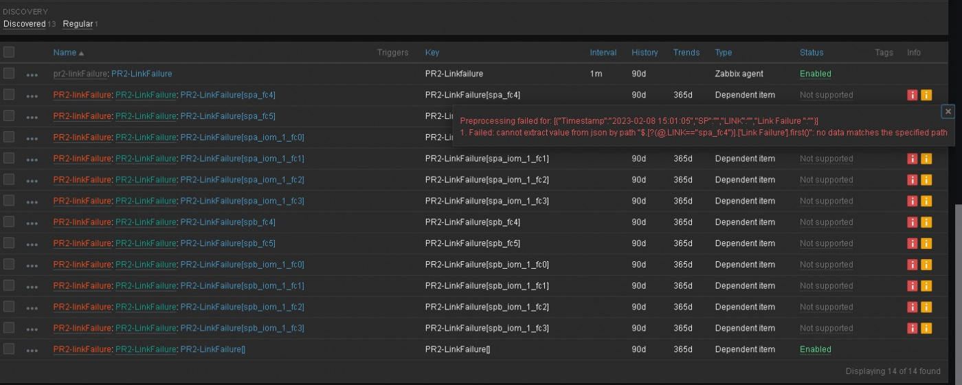

          Unfortunately it is showing follow error for me :
          HTML Code:
          Preprocessing failed for: [{"Timestamp":"2023-02-09 11:09:00","SP":"spa","LINK":"spa_fc4","Link Failure ":"1.000"},{"Timest...
          1. Failed: cannot extract value from json by path "$.[?(@.LINK=="spb_iom_1_fc3")].['Link Failure'].first()": no data matches the specified path​

            try all pre-processing steps within the same item and see if they work. also make sure each item has the right parent item.

              As it has created items just cannot get latest data I think that is relate to json path .
