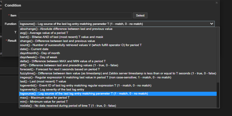

      Type of information: log
      Trigger: log[/home/ac_log/application/mmmmmm.log,java.lang.NoClassDefFoundError: Could not initialize class xxxxx.yyyyy.jni.JSGFPLib,1].logsource()}=1
      (is there any issue with error log keywords)
