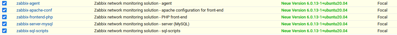

    I am running a Linux VM with Ubuntu Linux 20.04.5, Zabbix server 6.0.10, Webmin 2.013 and MySQL version 8.0.32-0ubuntu0.20.04.2. When I want to update the Zabbix packages. the server does not start anymore.
Name:	SNAG- 15.02.2023 14.41.25.png
    I get the following error message from the logs:​
