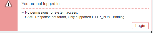

    The second question is if It should be possible to access Zabbix using the Endpoint URL = https://zabbix.domain.org/zabbix/index_sso.php?=acs. Becaus when I use that URL I get the following message from Zabbix
