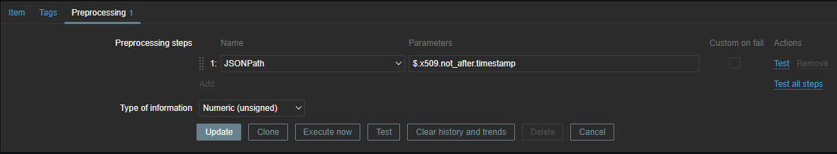

          I use the agent installed on Zabbix Server v 6.0 and I created an Item like below:

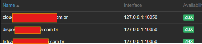

                Screenshot of my usage **I use the Zabbix Server itself for this

                  I'm seeing this when I use 127.0.0.1: "Get value from agent failed: Cannot establish TCP connection to [[127.0.0.1]:10050]: [111] Connection refused"
                  and this when I use zabbix-agent: "Get value from agent failed: TCP successful, cannot establish TLS to [[zabbix-agent]:10050]: SSL_connect() I/O error: [104] Connection reset by peer"
                  I belive it is running from the Zabbix server but I can't check if it is agent 2 - I'll be back in a couple of days.
                  • solution
                    • Jun 2020
                    • 272
                    If you are going to use the Zabbix Server and do not have SSH access to the server, you can use the "agent.variant" key
                    Create an item with this key and you will know if it is "Agent" or "Agent 2".
                    127.0.0.1: You should only create a host with this IP if you intend to use the Zabbix Server itself for the desired monitoring.
                    **See the "Zabbix Server" Host, it can be with localhost or with hostname and follow the same model when creating the new host for certificate monitoring.
                    Wellington
                    • msz@kommunekredit.dk
                      • Jun 2024
                      • 7
                      Nice - that should be a standard item in the template.
                      My problem was the encryption - it seems that the agent on the Zabbix server runs without encryption, I have to talk with the guy who installed it.
