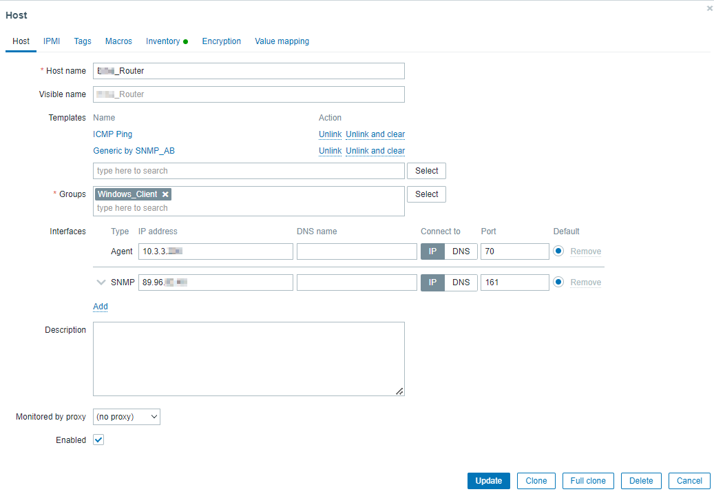

    Host with 2 interfaces
    Dear all,
    I've an host with 2 interfaces
    how can i refer to the interfaces ?
    HOST.CONN works (it is converted to the IP of the SNMP interface)
    I was hoping HOST.CONN2 would convert to the other IP but not.
    Anyone have a suggestion please?

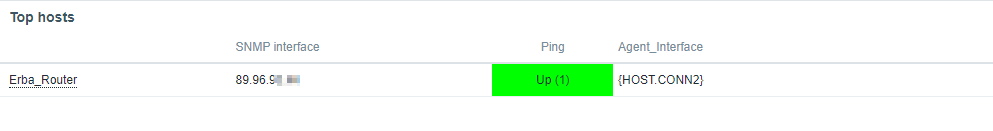

      I try to show my configuration.
      These are the item associated to the host​
      I would like to add a widget to the dashboard that summarizes the status of the pings (for each interface) , like this
      How can refer to the Host Agent interface (with IP​ 10.3.XX) ?
      Many many thanks !
      Have a good day
      Andrea

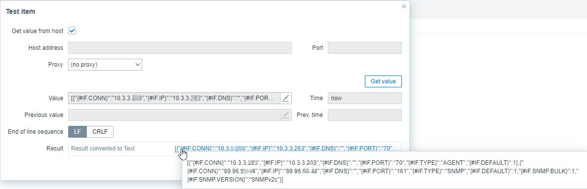

              I've created this Discovery rule for my host
              The TEST returns
              ​....and now ?
              What other operations/configuration are missing?
              How can use these results ?
              Thanks for your precious help

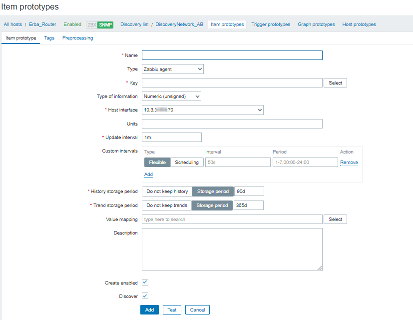

                  Now add item prototypes...

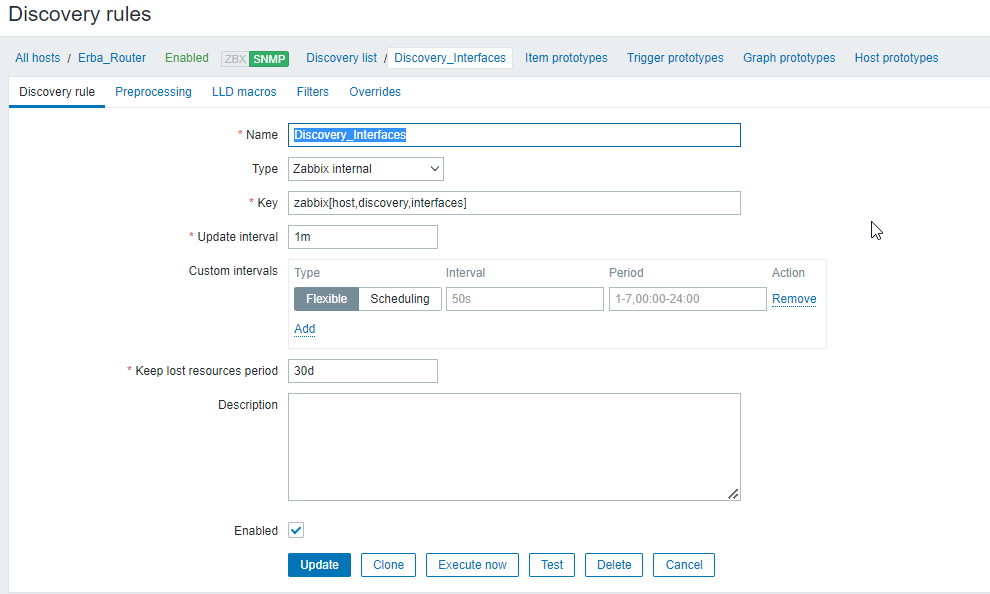

                  • TheBonaZabbix
                    • Feb 2023
                    • 67
                    Thanks but the doc is incomprehensible for my little brian.
                    This is my Discovery rule (type Zabbix internal)
                    I've to add Item Prototypes ?
                    How ?
                    Which Type ? Zabbix Internal ?
                    And the key ?
                    I can't figure out if I'm stupid or what I'm trying to do is difficult.
                        Type. simple check
                        key: icmpping[{#IF.IP}]
                        Rest of it you should be able to figure out... like data type (integer) and polling interval...​

                          • TheBonaZabbix
                            • Feb 2023
                            • 67
                            Dear Cyber,
                            with your help I can discover the interfaces. Many thanks.
                            Last question...
                            I'm trying to add in a dashboard a widget that contains each IP, like this
                            The text {HOST.IP1} or {HOST.IP2} are not converted in the value (IP address) discovered.
                            How can refer to these discovery values ?
                            Many thanks
                            Have a good week
                            Andrea​
