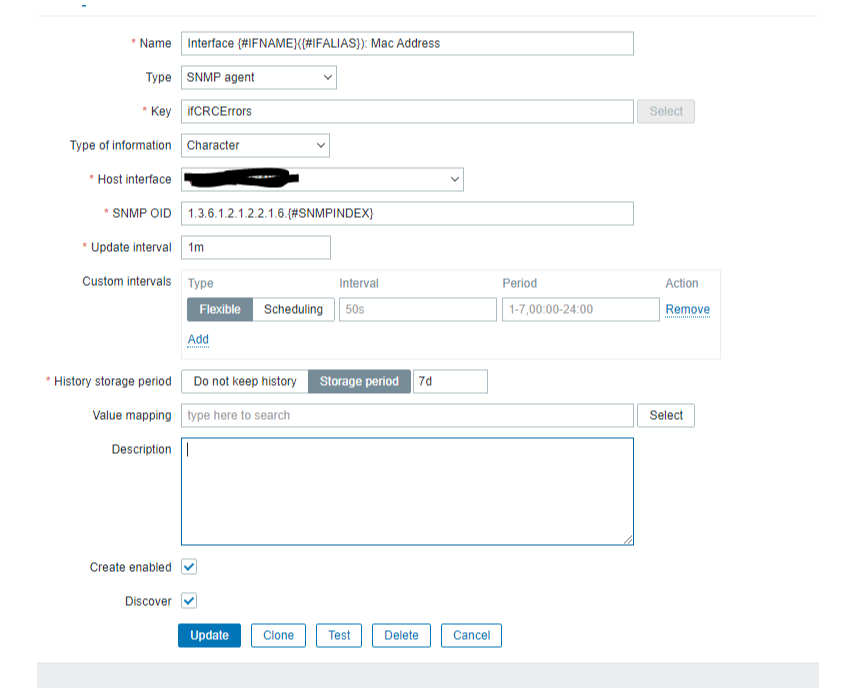

    I am trying to pull in the Mac address from the OID. I am able to snmpwalk a HP switch with OID 1.3.6.1.2.1.2.2.1.6 but when I create the item I get the error "Cannont create item with the same key" I've taken a snip of my item.
    Any insight is appreciated

    Fix key field - add discovery macros for unique. ifCRCErrors[{#bla-bla}]

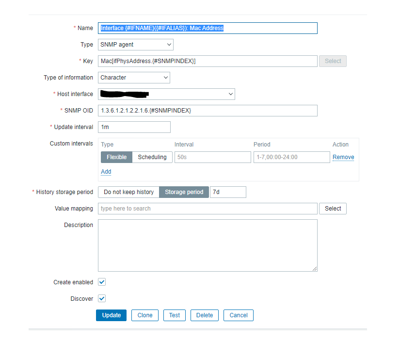

    • baltierrae
      • Sep 2022
      • 12
      I went back and changed the key. Worked! attached an image of the item
