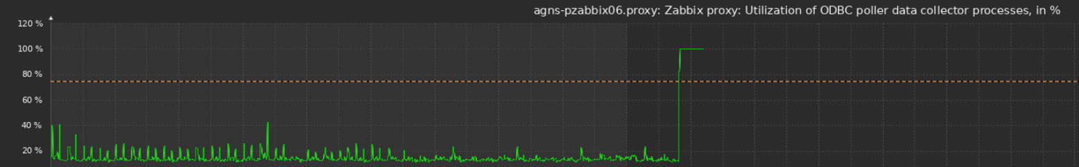

    We have a problem with our proxy performing ODBC check. When every DataBase are fine, ODBC poller are used at 15%. But when a databse goes down, ODBC poller goes to 100% (disturbing the others checks).
    I have checked in the proxy settings and the timeout is at 4 seconds.
    I surely miss an option but i can't figure out which.
