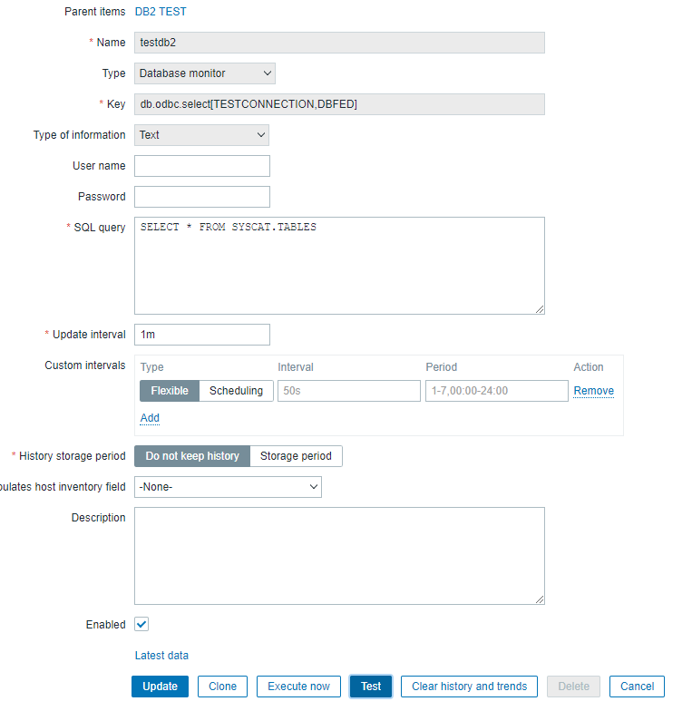

    After our successfully connection, we have try the following steps on zabbix gui.
    1) Create a new template
    2) Create a new item.

    When we test the Item we are receiving the following error.

    Can you help us/guide us please?
