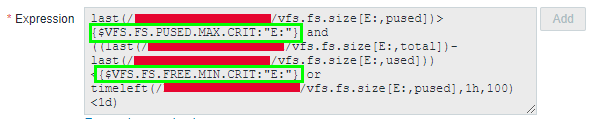

              Depending on what you're trying to adjust you may need to add some contextual information. In the case above, I needed to add E: to the macro. You can reverse engineer a templated trigger to fins the syntax required by going to the Triggers tab in the Host config page. Click into any trigger or dependency to find the syntax:
              The Expression section will have the Macro(s) in the correct syntax:
