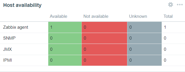

      Thanks for the response, Hamardaban.
      Note that while these agents with Active checks are showing as available in the host list (see first screenshot) they are not showing up in the Host Availability widget. So there's no issue with them being counted as available... but they don't show up (not even as unavailable) in the Host Availability widget (see second screenshot). That's the crux of my question.
      Any ideas why this might be the case?​

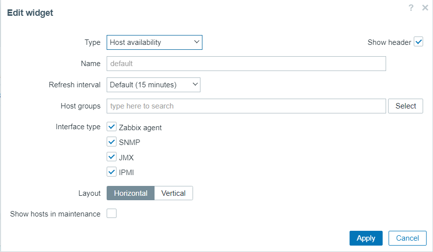

        Look at the widget settings - which host groups are shown? Which interfaces are shown?
        • PYarra
          • Mar 2023
          • 7
          No host groups are selected, so I assume this means all hosts are displayed (no filtering) but only 1 host shows in the Host Availability widget. If I select the host group to which the 2 servers that aren't showing up belong to, it shows 0 hosts.

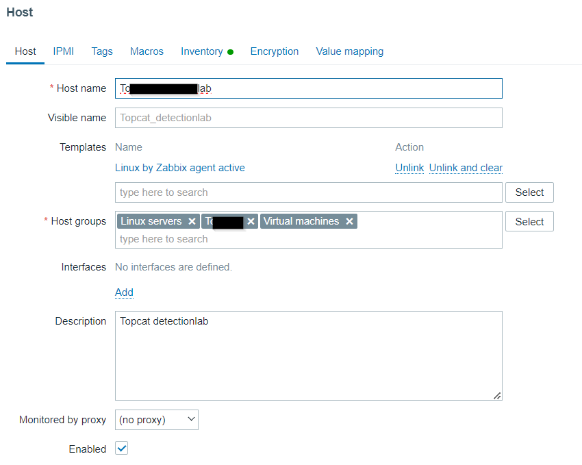

            In the picture with the list of hosts, I do not see interfaces for "problematic" hosts. Show the settings of one of them.
            • PYarra
              • Mar 2023
              • 7
              There are no interfaces to add, because they're not reachable to be polled - they're only doing active checks.
                • 5007
                That may be the issue... no interface, no numbers... Might aswell be bug in widget, as having an interface is not mandatory any more...
                • PYarra
                  • Mar 2023
                  • 7
                  Yeah, that's my suspicion too. Everything I've read indicates that a host is considered available if the active agent heartbeat keeps coming in. They just don't seem to show up in this widget (which is a pity because it's the first thing new users see in the dashboard)
                    • 5007
                    Well, widget works based on "selected interfaces"... If no interface, then you cannot select it and it wont show up.. So, you can say, works as intended. But in reality, needs update to reflect currently possible options. You can submit bugreport to https://support.zabbix.com/projects/ZBX/issues
