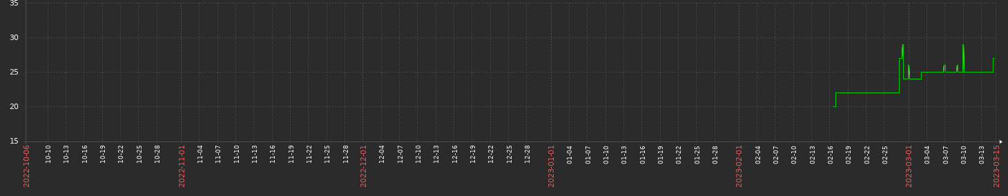

            I did this also for another update check where i set this (non security updates trigger) to 160d. Now i do not have any measurements this long (see attached graph) and still the trigger is activated. How do i set the trigger to look only if the value is indeed >0 for the periode of 160days even if there is no data for that long?​
              Consult the manual..
              There are trend functions. Personally, never used them, but I think they should do the trick...

                  I found an way to work with it though some agents still are not working properly, i have decided to disable the monitoring for the agents that are not working for this 160days trigger as it takes up to much time . For now this is what i did. look for the value you want, count this in these days, then also look for nondata as new hosts do not have history:
                  min(/ubuntu-server/ubuntu_updates.package,160d)>0 and count(/ubuntu-server​/ubuntu_updates.package,160d)>0 and not nodata(/ubuntu-server​/ubuntu_updates.package,160d)=1​
