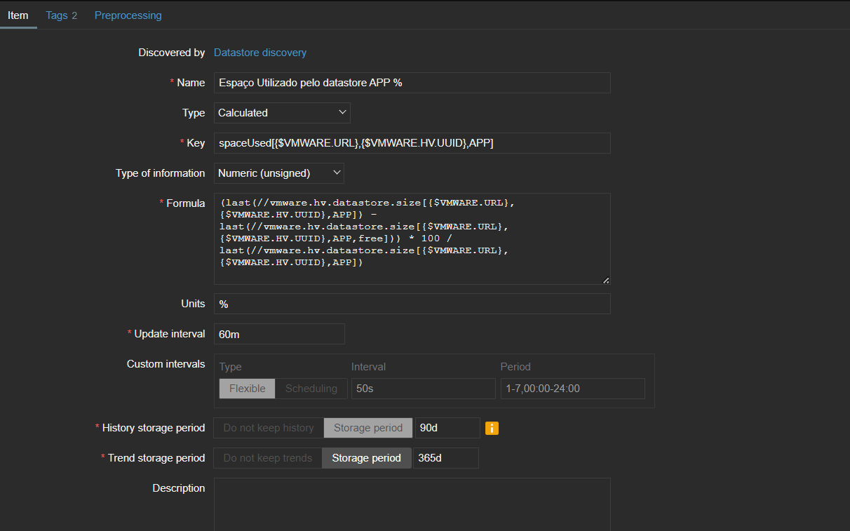

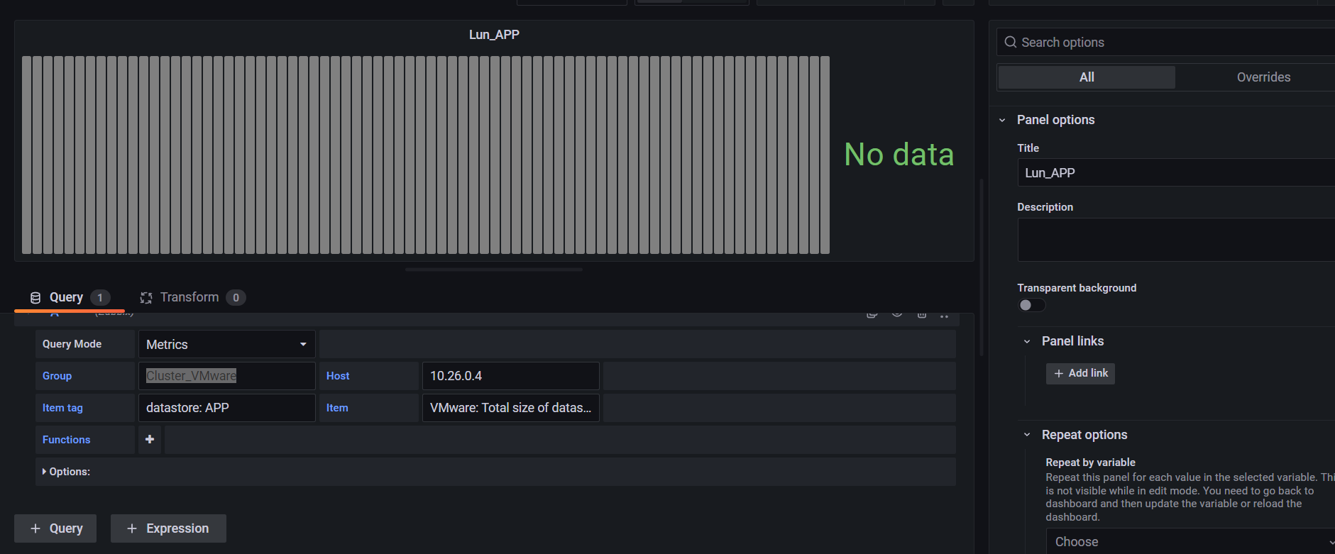

    I need help to show the percentage of disk usage on Dell's IDrac, but it is not bringing the results.
    What can I do to apply a workable solution ?

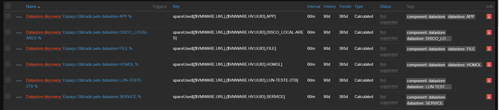

    You do see those red exclamation marks and note "not supported" there on one of pics? If you hover your mouse over that "!" then you should see the error message... Could you fix the issue there?
    No point in trying to show data in grafana, if your source is already broken...

      Cannot evaluate function: item "/4c4c4544-0050-3910-8050-c4c04f333933/vmware.hv.datastore.size[{$VMWARE.URL},{$VMWARE.HV.UUID},APP]" is not supported in "last(//vmware. hv.datastore.size[{$VMWARE.URL},{$VMWARE.HV.UUID},APP]) - last(//vmware.hv.datastore.size[{$VMWARE.URL}, {$VMWARE.HV.UUID},APP,free])) * 100 / last(//vmware.hv.datastore.size[{$VMWARE.URL},{$VMWARE.HV.UUID},APP])" .
      I need to return this information according to the image below.

        It says that item used in calculations is in not supported state..
        I suppose that 4c4c4544-0050-3910-8050-c4c04f333933 points to UUID of the host.
        So first you need to fix ordinary items, then calculated items fix themselves...

          I performed the adjustment and it worked .
          Plus the time was wrong!
