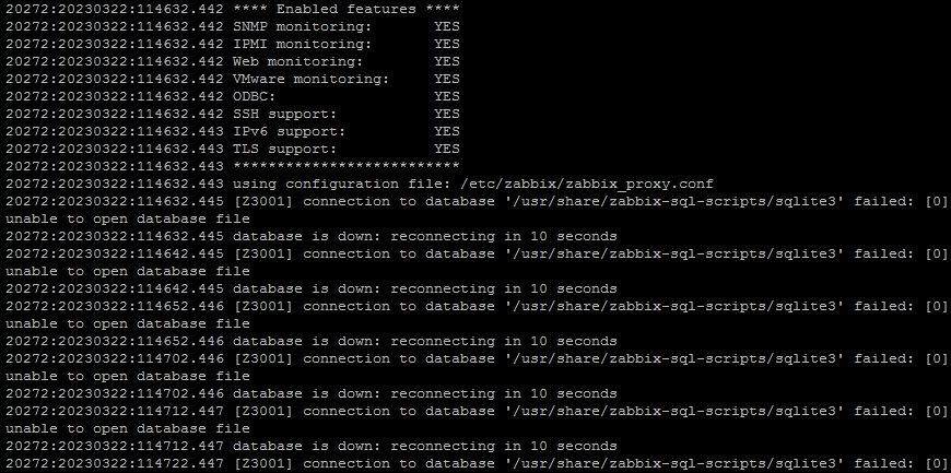

    I installed the zabbix 6.4 (proxy) on CentOs 7 with SQLite3, but it gives an error "database is down" and "unable to open database file"
    DBName=/usr/share/zabbix-sql-scripts/sqlite3​​

    I think the specification of DBName is wrong. Isn't that path the directory where the scripts for database creation are stored? Set DBName to the path to the database you created using the script. Try creating a database file using the sqlite3 command and setting the path for that file, as the manual says.

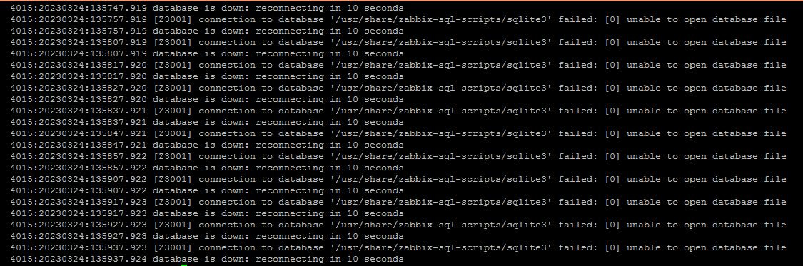

      Dear Atsudhi Thanks for answer, i changed DBName to /usr/share/zabbix-sql-scripts/sqlite3 but give error "database is down" and "unable to open database file"
      i did cat /usr/share/zabbix-sql-scripts/sqlite3/proxy.sql | sqlite3 zabbix.db, There is both proxy.sql and zabbix.db (See in z2 image)
        DBname should point to the file, what is used for DB. Seems you are currently trying to point it to a directory... add a filename (maybe point to some other mountpoint, where you have dedicated room for it)...

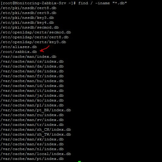

              The zabbix database file is located at the root, see z3 image
              but I put the name of the zabbix.db or root/zabbix.db, it did not work

                Is the proxy running as the zabbix user? Shouldn't the /root directory be accessible by the zabbix user? Try creating a database file with permissions editable by the zabbix user in a directory accessible by the zabbix user.

                  i used below command for create zabbix database:
                  yum install zabbix-proxy-sqlite3 zabbix-selinux-policy zabbix-sql-scripts
                  Can you tell me the commands for creating a database file with permissions editable by the zabbix user?
                    If you really insist on preconfiguring that db ...
                    cat /usr/share/zabbix-sql-scripts/sqlite3/proxy.sql | sqlite3 /tmp/zabbix.db
                    Set DBName in proxy config to /tmp/zabbix.db
                    But as I said, it is enough to set your DBname to a file (with full path), what is acessible and writeable to zabbix user.
