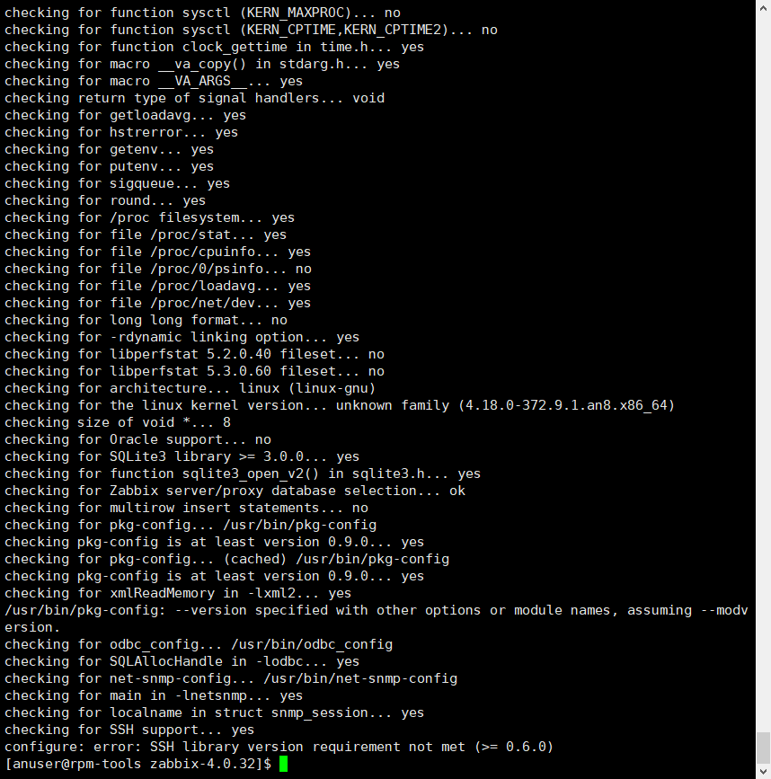

configure: error: SSH library version requirement not met (>= 0.6.0)
  • 哈破小菜鸟
    • Apr 2021
    我尝试构建基于CentOS8的rpm包, zabbix版本是4.0.32
    执行rpmbuild -ba zabbix.spec 过程中报错
    相关组件包都已安装, 软件源里找不到sshlibrary相关的软件包
  • tim.mooney
    • Dec 2012
    • 1436
    RHEL 7 used 'libssh2', but RHEL 8 switched to 'libssh', since libssh2 wasn't seeing active development.
    To build with libssh on RHEL/CentOS 8, you probably need to
    sudo yum install libssh-devel
    Zabbix 4.0.18 and later supports either one: https://www.zabbix.com/documentation...n/requirements
