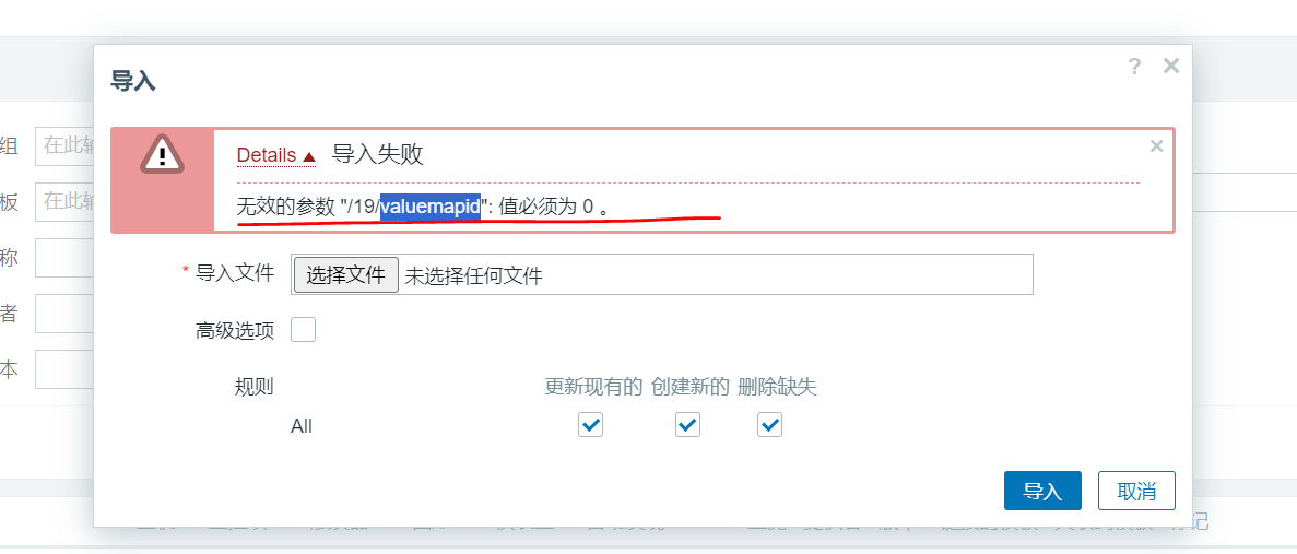

            • bweblusrqjvjfwj
              • Aug 2023
              hi ,I have some issue
              I use this
              HTML Code:
              https://github.com/Sean-Bradley/SNMP2ZABBIX
              to covert mib to template
              use python SNMP2ZABBIX.py ./SANGFOR-GENERAL-AND-SSL-MIB 1.3.6.1.4
