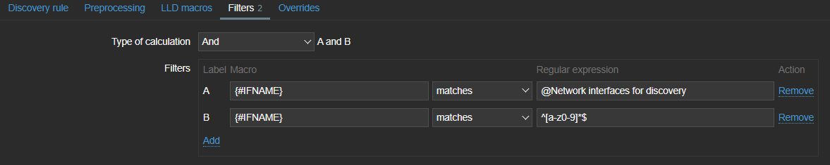

    I'm using net.if.discovery to discover my interfaces.
    This will give me all the interfaces of my device, which is good.
    I now want to create a discovery for physical interfaces, because I would like to make an item for Ethernet Speed.
    I do not want this info for the VLANS as they would be the same as the physical interface.
    So I cloned my discovery rule with net.if.discovery I added a filter which removes the interfaces with an embedded dot, renamed the description...
    And then I found out I can't save it, because I already used net.if.discovery

    I think I found the answer here...
    https://www.zabbix.com/forum/zabbix-...iscovery-items
    It was a bit unexpected that I needed to define the alias on the agent
    Alias=physif_discovery:net.if.discovery
    Click image for larger version  Name:	image.png Views:	1 Size:	7.1 KB ID:	462272
    Click image for larger version  Name:	image.png Views:	1 Size:	18.4 KB ID:	462271
    The most important item was this one

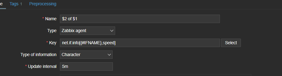

    UserParameter=net.if.info[*], ifconfig $1 | grep -i $2 | grep -o ':.*' | cut -b3-​

      and using $1, $2 etc in item (and prototype) names has been deprecated for a long time...
