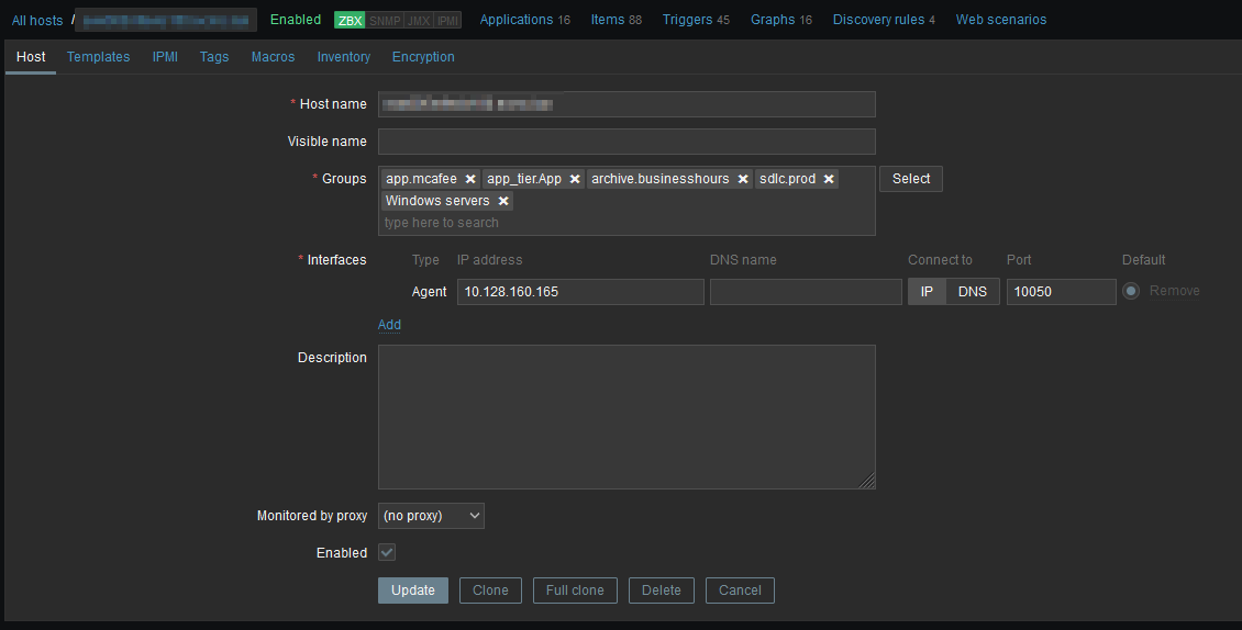

    The problem we are having is that the action trigger IS sending notification of triggers that do not meet the condition requirements. For example, failed windows services. Here's one of the hosts in question:
    Based on the action trigger conditions, I would have expected the windows service problem trigger shouldn't have triggered a notification to the on call because :
    1. The Windows service trigger default severity is 'Average' -> doesn't satisfy the action trigger A condition.
    2. The monitored host IS a member of the archive.businesshours host group, -> doesn't satisfy the action trigger B condition.
    Yet the notification to the on-call is sent anyway.
    1. We have verified this is the only action trigger that sends notifications to the on-call.
    2. We have verified the problem trigger severity is indeed 'average' and not overridden to high.
    Thoughts?

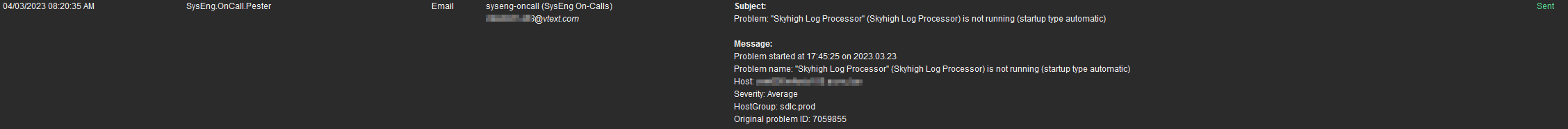

          Right, when I stated at the beginning that we are seeing notifications going to the oncall person, we saw this via the action column for the event in the Monitoring and Problems view. As for the action logs, they are not revealing anything we don't know already, the notification is being sent to the oncall event though it shouldn't:

            It's odd, indeed.
            Based on the action message that was sent, it seems that the problem initiated on 23rd March 2023 at 17:45 hours. However, the email notification was sent only yesterday.
            Do you have any escalation steps ​or recovery/update operations in place?
            • jhboricua
              • Dec 2021
              • 114
              The notification is meant to pester the oncall until it is acknowledged, so don't worry about the dates shown above. I kept this one unacknowledged while I'm troubleshooting it.
