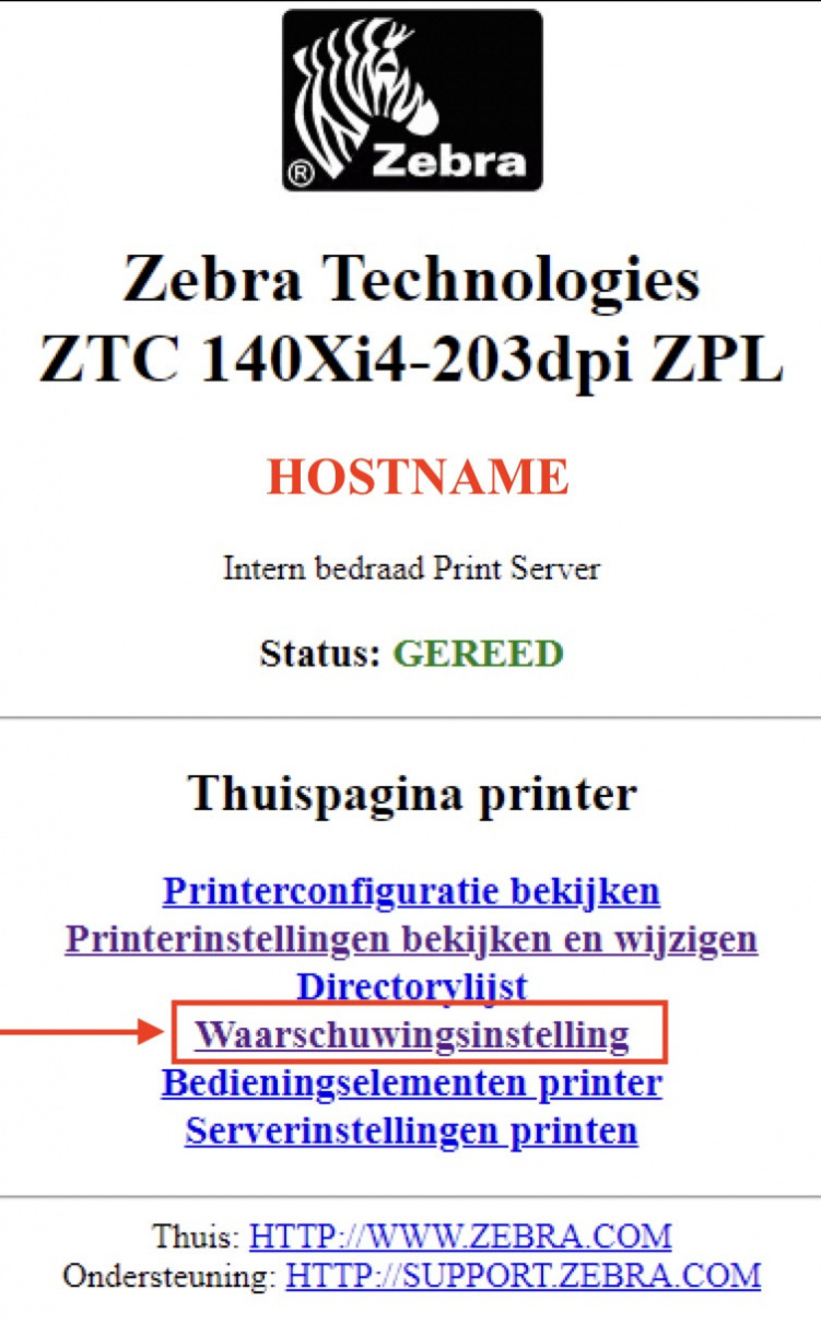

    Zebra printer setup
    Assuming you were able to setup your system to receive SNMP traps, you can continue these next steps. This manual should work on all Zebra label printer models (below instructions were tested on ZTC 140Xi4-203dpi ZPL and ZTC ZT620-203dpi ZPL).
    1. Login to the webinterface. The default user name is "admin", and the default password is "1234".
    2. Go to "Alert setup" ("Waarschuwingsinstelling" in Dutch).

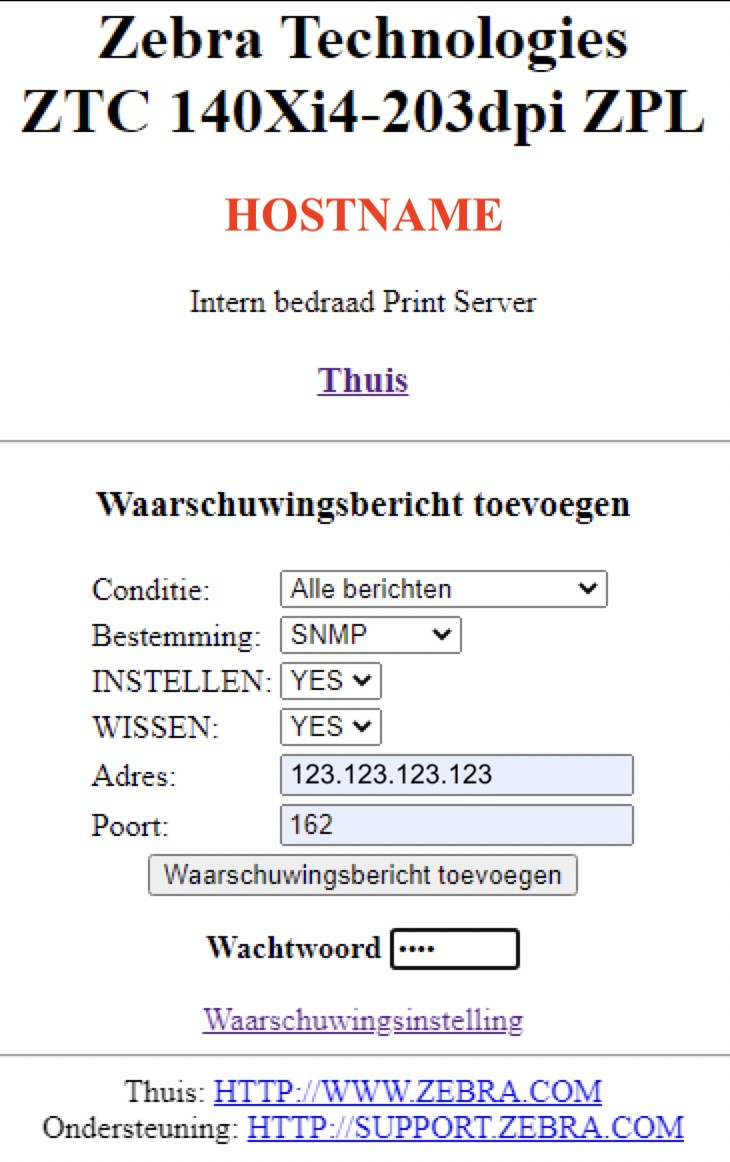

    3. Add an alert ("Waarschuwingsbericht toevoegen" in Dutch)
    4. Now do the following:
      • Set "Condition" to "All messages" (Alle berichten in Dutch).
      • Set "Destination" to "SNMP".
      • Leave "SET" ("INSTELLEN" in Dutch) as "Yes" if you want Alert sent when condition is met.
      • Leave "CLR" ("WISSEN" in Dutch) as "Yes" if you want Alert sent when condition is cleared.
      • Set "Address" to the IP address of your Zabbix server/proxy (invalid IP 123.123.123.123 used in this example).
      • Set the "Port" to "162" which is the default for SNMP traps.
    5. Now enter the password in below field before clicking "Add alert message" ("Waarschuwingsbericht toevoegen" in Dutch), otherwise your setting will be lost!
    6. Do not forget to save the printer settings so it is not lost after reboot!

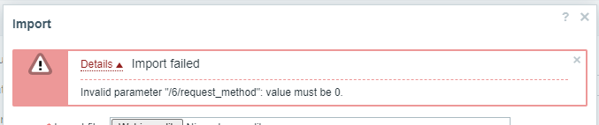

  • bicker
    • Apr 2023
    When importing a template, I have a message.
    can anyone help ?
