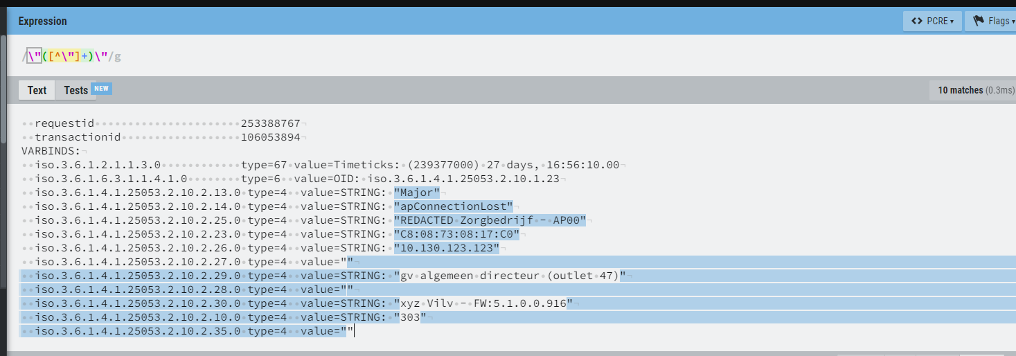

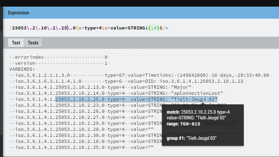

      Hi markfree, thanks for the reply, RegExr works indeed to test the syntax. It seems allso that i needed backslashes before the . characters.
      However, i think it must be something i'm doing wrong in zabbix. I've gotten the regex working on RegExr for 1 line, but when i put that in zabbix it still displays the entire item value with the regsub code behind it (see screenshots)
      I've tried so many different options, I'm lost here...
      Is this a bug in zabbix or am i doing something wrong?

        Looking at your screenshots, again, you seem to be missing some quotes as well as the Regsub output.
        ​Check the Regsub function syntax on the Macro Functions documentation.

          Hi, you are correct. I was missing that in the screenshot. I've fixed that but then the result is empty. I've added \0 wich should be the matched text according to the documentation, so it seems that there is no match, but the expression is valid on RegExr.
          To test i allso added \2 and \3 in the case zabbix had different capturegroups but hose are allso empty.

            Based on your first trap example and considering that you need some values inbetween double quotes on multiple lines, you may need to use the "regsub" function multiple times.
            If your trap does not change its content spacing, the previous expression with fixed spacing and dots will probably work out.
            See if this works:
            AP Connection Lost: {{ITEM.VALUE}.regsub("25053\.2\.10\.2\.25\.0 type=4\s+value=STRING: \"(.*)\"", \1)} - {{ITEM.VALUE}.regsub("25053\.2\.10\.2\.29\.0 type=4\s+value=STRING: \"(.*)\"", \1)} - {{ITEM.VALUE}.regsub("25053\.2\.10\.2\.26\.0 type=4\s+value=STRING: \"(.*)\"", \1)}
            Note that the only changing value is the line OID number.

              The one that worked (somewhat) catches all strings between double quotes, and creates a seperate group for each match. This works in zabbix, but only for the first capture group.
              {{ITEM.VALUE}.regsub(""([^"]+)"", \0 \1 \2 \3)}
              Regexr test: 3 matches

              I can only conclude that zabbix does not support the global mode or uses another syntax or whatever, because this makes no sense to me.
              ALL of 40+ other did not work and gave a no match result. And i know that there are no syntax errors in them because then it displays the full text as posted before instead of a no match(empty trigger name).
              Since its no use for me to only be able to use the first capture group i'm about to give up on this and will probably send the traps to something like this (https://github.com/phpipam/php-snmptraps) to recieve the traps and resend them with a custom script with zabbix sender or something not sure yet if its worth the effort. i might just leave the entire trap in the trigger name depending on what my manager decides, but the amount of hours spent on this is not really worth the trouble to be honest.

                Indeed, Macro Functions do not support multiline matching.
                Testing with Regexr, to match Zabbix "regsub" function, you should switch to PCRE engine and turn off the global flag (/g). This way, only the first match will be found.
                Because of this, you may need to use the "regsub" function multiple times as I mentioned previously.
