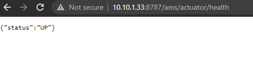

      I just need to get 200 response or text {"status":"UP"} to make sure that the service is working, after adding the desired item, I will set up the trigger.

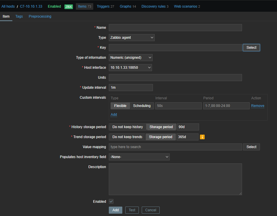

      Yes, I use localhost(though it doesn't matter I can use his ip), because I want the agent that is installed on this server to do the check (so as not to give extra rights for Zabbix Server).
      At the moment, I can’t set up an Item to attach a trigger to it....
      I'd appreciate the options....​

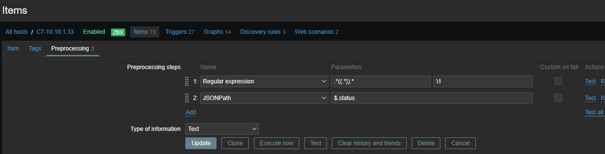

          Thanks for helping! now I'm looking for why it's not coming Latest data...
ID:	462754Click image for larger version
ID:	462756 It works, but for some reason I don’t get data, I’m looking for a problem.​​

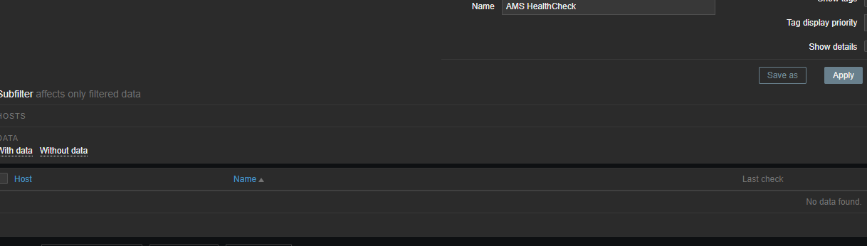

                        It does not give any errors, in my opinion everything looks correct, but the Latest Data isn`t accumulated.
                        This is the question I am currently trying to solve....

                        History is just as empty.

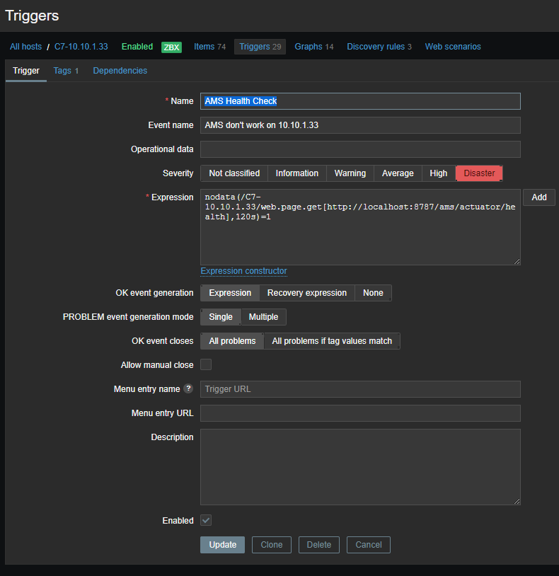

                        As for triggers, I set up the simplest one, although I was surprised that it works, although there is no Latest data.(it fires if i disable my service)

                          How are your items configured? If you want to check the status 200, did you remove the Precessing that I introduced at the beginning?
                          Also, if you stop the service with a trigger, it will be judged as a failure because you have set it using nodata(). If you want to make sure the status code is 200, create the trigger to something like that.​
