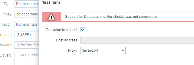

Support for Database monitor checks was not compiled in.
  • musac
    • Apr 2023
    Hello, I installed zabbix version 6.2.6 from the source code. everything works, but when I want to monitor the database as database item type, I get the error "Support for Database monitor checks was not compiled in." I am using Ubuntu version 22.04 and the ODBC driver is installed. I can connect to servers and run queries with zabbix_get. can you help?

    I guess you need to recompile with odbc support enabled...
    • musac
      • Apr 2023
      Thank you. Good point. I tried it and it worked.
