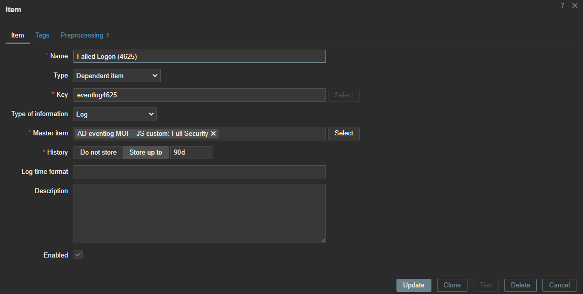

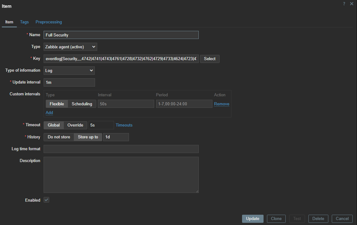

          I had the same problem and found a solution that might be useful to someone else. The problem lies in the method used by the agent to poll the log file. For each item created, it starts reading the log from the beginning, and with a large number of logs, it simply starts to fall behind.
          What I did:
ID:	511183Click image for larger version

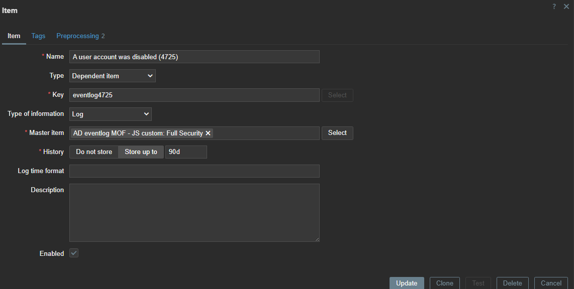

          I have Zabix 7.0, I created 1 item that downloads the entire log section and filtered only the IDs I need in it.
          Next, I created dependent items for this main item, which I essentially used as a buffer for logs.

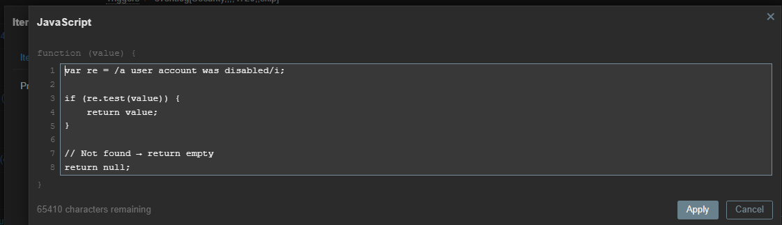

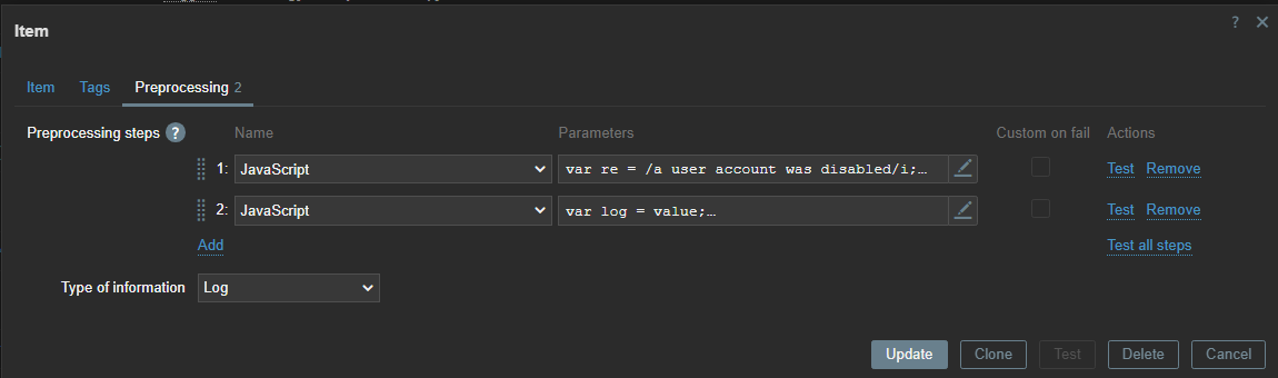

          • mmeducation1337
            • Feb 2026
            and in it I used JS preprocessing to find the log ID I needed (don't pay attention to the second js, I just use it to make the log look nice in the message)
