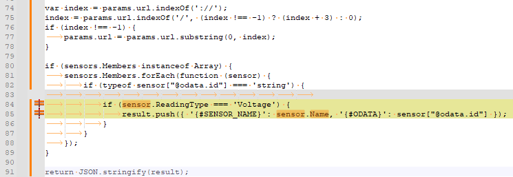

        I have solved this temporarily to run a proof of concept with about 1.2k servers. The problem I've run into was less that the API was taking more than 10 seconds to respond, but rather the preprocessor was taking more than 10 seconds, even when I set script execution to timeout after 60seconds. It doesn't appear I can adjust that timeout. So to fix this I've used the `$expand` parameter mentioned by omgiafs so instead of sending a query for every entity, it sends one. I've modified some of the preprocessor scripts to then iterate over _that_ response.
        Disclaimer: This is not a good solution and I plan to rewrite this template if we proceed after our proof-of-concept. Until then...
        Dell R740 by HTTP // PSU discovery
        1. Add a query parameter to the discovery rule:
          • Name: $expand
          • Value: *($levels=1)
          • Click image for larger version
        2. Edit the 1st JavaScript function under the Preprocessing tab
          • Empty line 83 that is performing another request (we don't want to run more queries)
          • Since we aren't running anymore queries we need to point the sensor contents to the previous query to extract into.
            • Line 84: Change getField(response.body, 'ReadingType', '') to read sensor.ReadingType
            • Line 85: Change getField(response.body, 'Name', '')to read sensor.Name
        The full content of the preprocessor is:
