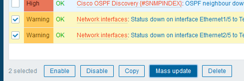

        I can not put the tag on the lld trigger, then I get the same tag on every interface.
        I need temp tags on the triggers them self to correspond to the actual upgrade.
        Here I try to add tags on the trigger for the interfaces.

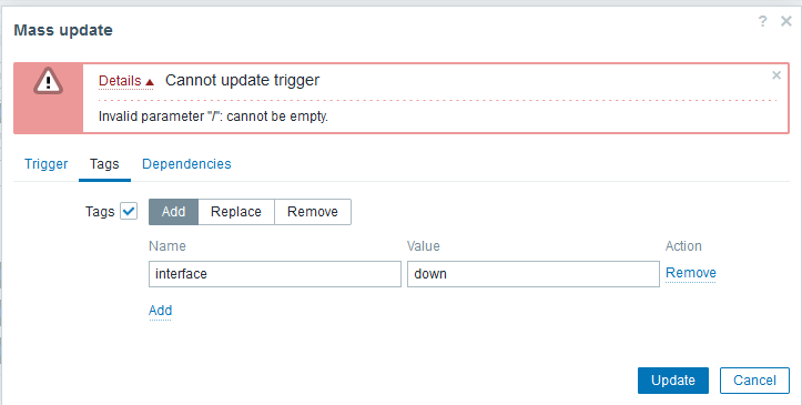

        Some tag and value.
        And error message.
        • Hamardaban
          • May 2019
          • 2714
          You should assign tags during the LLD process, not afterwards.
          • andhag
            • Dec 2022
            • 14
            So I should put one individual tag on all interfaces triggers in all distribution switches, and then in maintenance dialogue add this tags one by one?
