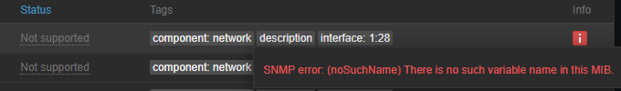

    However, on the 'Data Collection' > 'Hosts' screen i can see that there are ~2300 items. If i click on 'items' and click on one of the switch interfaces, it displays that 'Bits received' and 'Bits sent' are 'Not Supported'

    Downloading and installing the MIB in this case most likely has nothing to do with it at all.
    You need to figure out how LLD works and what SNMP tables are, find out which OIDs contain the information you need and, if necessary, adjust the template.

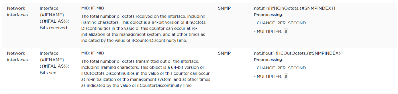

      Not sure why these are not working as Extreme Switches are clearly supported out of the box with Zabbix (see below)

      Why is it showing as not supported?​

        Maybe I'm wrong - after carefully reading the error message. Your OIDs are written in text notation and it is not possible to request them. Try to rewrite in numerical notation.
        Request the OID directly from the command line (snmpget) and look at the error messages.
        And try to disable "Use bulk requests" in the interface settings

          Ok so seems like it is working if i use snmpget with the OID in Zabbix manual.
          However, if i leave it as OIDxxx.{#SNMPINDEX}, i get an snmp_parse_oid(): cannot parse OID "1.3.6.1.2.1.2.2.1.10.{#SNMPINDEX}". error
          If i change the {#SNMPINDEX} to the acutal port number (1001) in this case, it retrieves the value correctly ​
