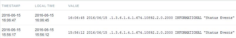

    same value line trigger detection
    i have an item "SNMP Trap" and it work well. Now i make a trigger and want check if a new line is detected in the item snmptrap but the problem is i have the same line value but ofc not the same date :
    How to detect with functions there is a new line appear ?
    regards.

        The problem with "diff" fonction is it check difference between last and previous "value" and my value is the same ! the only difference is on the "TIMESTAMP" and "LOCAL TIME".

          Yes, but your value contains timestamp.
          So the strings are different.
