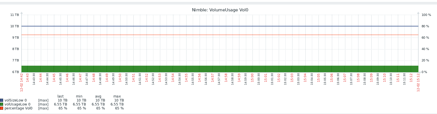

        In case anyone is interested I just created a minimalistic nimble template that can be used with zabbix 7 at github
        • kb1648
          • Aug 2024
          Interfaces and processors.
          • aseques
            • May 2019
            • 40
            Just letting know that I updated the template with the occupation graphs, the repo is here, it would still need some improvement to do autodiscovery, but so far I'm ok with what it does.
