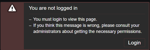

    I installed Zabbix on a Ubuntu 22.04 VM in hopes of testing it together with iTop and GPLI. At first I could log in into Zabbix but after installing GLPI I got the follwing error every time I logged in:

    I did not really change much in the php.conf file or similar. The only changes I did were the following:
    PHP Code:
    memory_limit = 64M ; // max memory limit
    file_uploads = on ;
    max_execution_time = 600 ; // not mandatory but recommended
    session.auto_start = off ;
    session.use_trans_sid = 0 ; // not mandatory but recommended
    Did someone encounter this problem before?

    Okey I think I found the problem. I changed the memory_limit in the php.ini file which caused the application not to run anymore.
