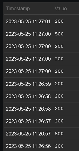

    As you can see, the logs are collected correctly (statuses). It's look same for collected type of Text and Log.

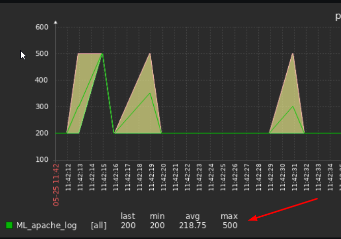

    However, how to set the "Type of information"? As Text, Unsigned, Log? I would also like to collect statuses as Graph - stacked.
    When I use Unsigned, they are collected as a value - that is, the Graph exists, but it is skewed - the value is collected, not the occurrences (I would like to create my Graph by accumulating occurrences on a given time interval, e.g. 1 minute - but I can't add a data source because it is not among the elements to choose from)

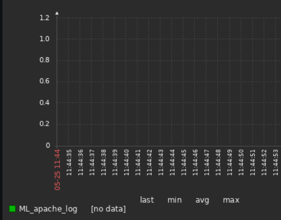

    - in case of using Log, Graph is empty (no data)​
    Graph of Unsigned:

    Graph of Log:
