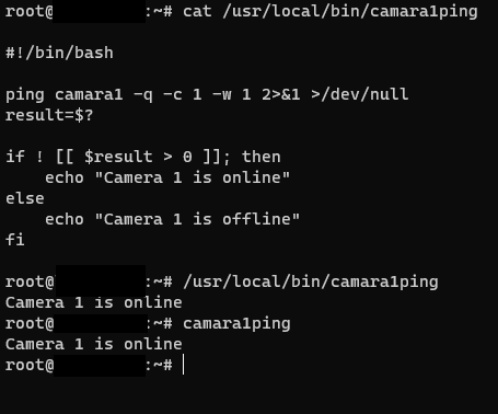

    I am having issues with a UserParameter - the bash works - but in Zabbix, I am getting garbage back.
    It seems to be an issue on Agent2 - for my old debian 6 hosts on the old agent - its working fine.
    Here you can see that the bash works OK...

    The permissions on the script are fine - I even tried setting them to 777. Still the same issue persists. This happens on all my debian 10 hosts with agent2 on them.
    I tried this as a straight UserParameter, like this:
    UserParameter=camara1.pingstatus,ping camara1 -q -c 1 -w 1 2>&1 >/dev/null; result=$?; if ! [[ $result > 0 ]]; then echo "Camera 1 is online"; else echo "Camera 1 is offline"; fi
    But it produces the same result. This is why I tried moving it to a script in /usr/local/bin.
    I would love some advice or insight here. Anything for me to check - I have struggled with this for days.
    I am expecting to see only "Camera 1 is online" or "Camera 1 is offline" - nothing else. How can I trim this down? It should not be sending this to Zabbix, but it is. I am not even sure how it generates the garbage to begin with - as the script works without piping anything to stdout.

            The result in Zabbix is still:
            /usr/local/bin/camara1ping: 7: /usr/local/bin/camara1ping: cannot create 0: Permission denied
            /usr/local/bin/camara1ping: 7: /usr/local/bin/camara1ping: [[: not found
            Camera 1 is online​
            The data doesn't even make sense. I am quite sure my bash is OK - so I really have no idea where the extra crap is coming from. The "Camera 1 is online" is there - there is just the extra, invalid stuff there. Its not like the bash is failing - the result is there, and correct.

                I changed my bash from:
                to:
                ping camara1 -q -c 1 -w 1 > /dev/null 2>&1; result=$?; if [ $result -ne 0 ]; then echo "Camera 1 is offline"; else echo "Camera 1 is online"; fi;
                And now - on Debian 10 at least - I get the result I need in Zabbix.
                Yay!!!
                I will update the rest of my hosts, and see if I spot any other oddities, and then close this with my findings.​
                  Even if they say, that order of words and letters in a sentence does not matter, you still understand, does not work with programming .. Seeing all the correct words, but in wrong order...and no bells ringing..
                  redirecting is either ">/dev/null 2>&1" or "&>/dev/null" but not "2>&1 >/dev/null"
