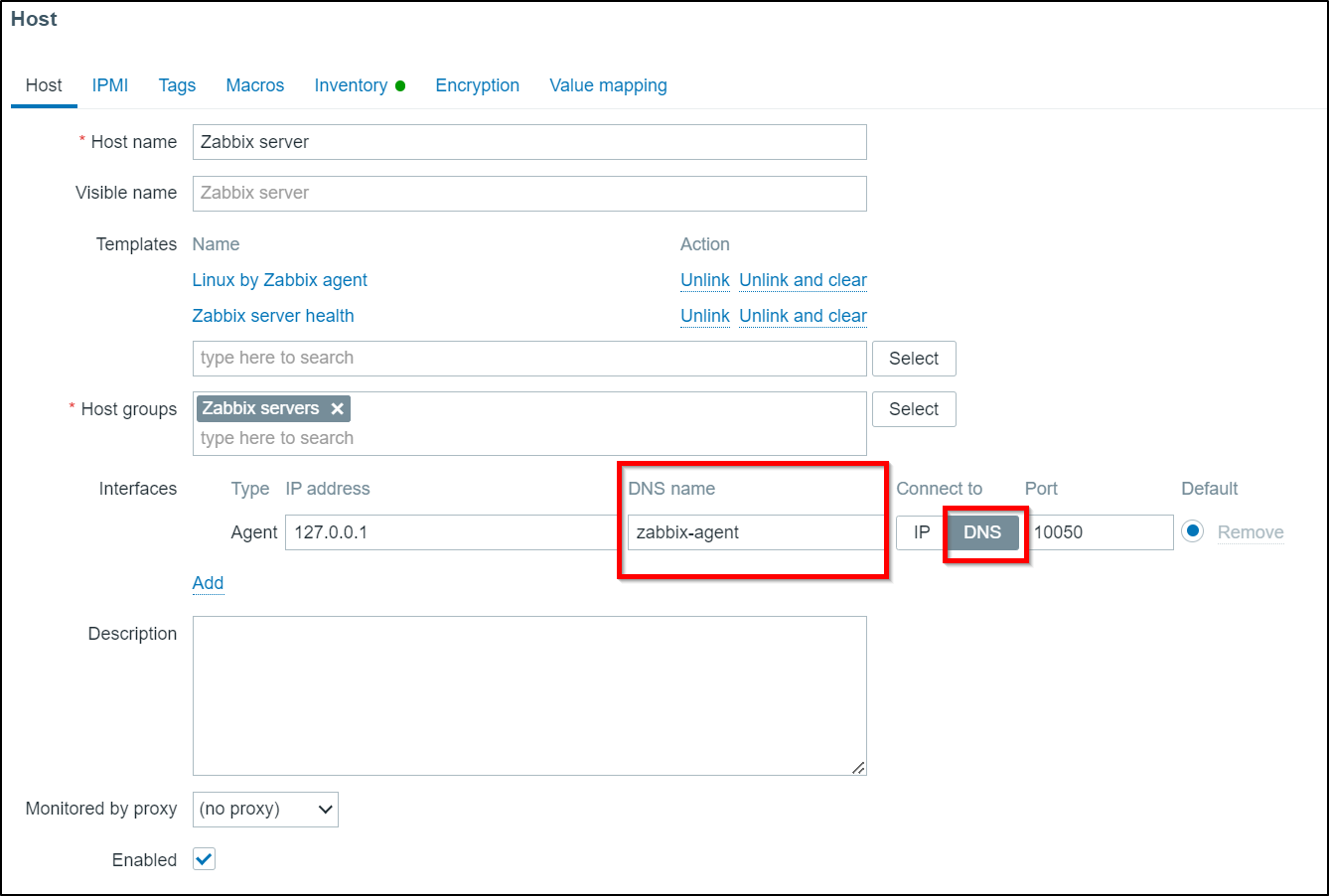

      127.0.0.1 are faulty configuration when using the supplied docker-compose files. We have to use the docker hostname / alias:
      Now my agent are connected correctly. Maybe the repo can be updated so the default installation will work better.​

        "127.0.0.1 are faulty configuration when using the supplied docker-compose files. We have to use the docker hostname / alias:"
