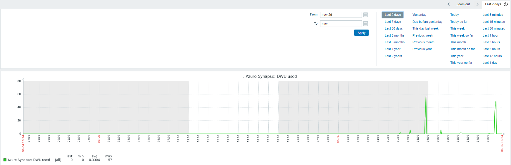

    Hi, I’m facing this problem where the data keep changing/ inconsistent after every time frame filtration.
    1. Why does the data result only include the green line graph when it is filtered as 2 days (as you can see from the screenshot 1.0, it will take 0.5 as the result, instead of 1.0 as shown in the screenshot 3.0)?
    2. What does the pink link line mean?
    Btw I’m using Zabbix v6.0.
    Screenshot 1.0 - This is how the graph looks like when the time frame is filtered as 2days:

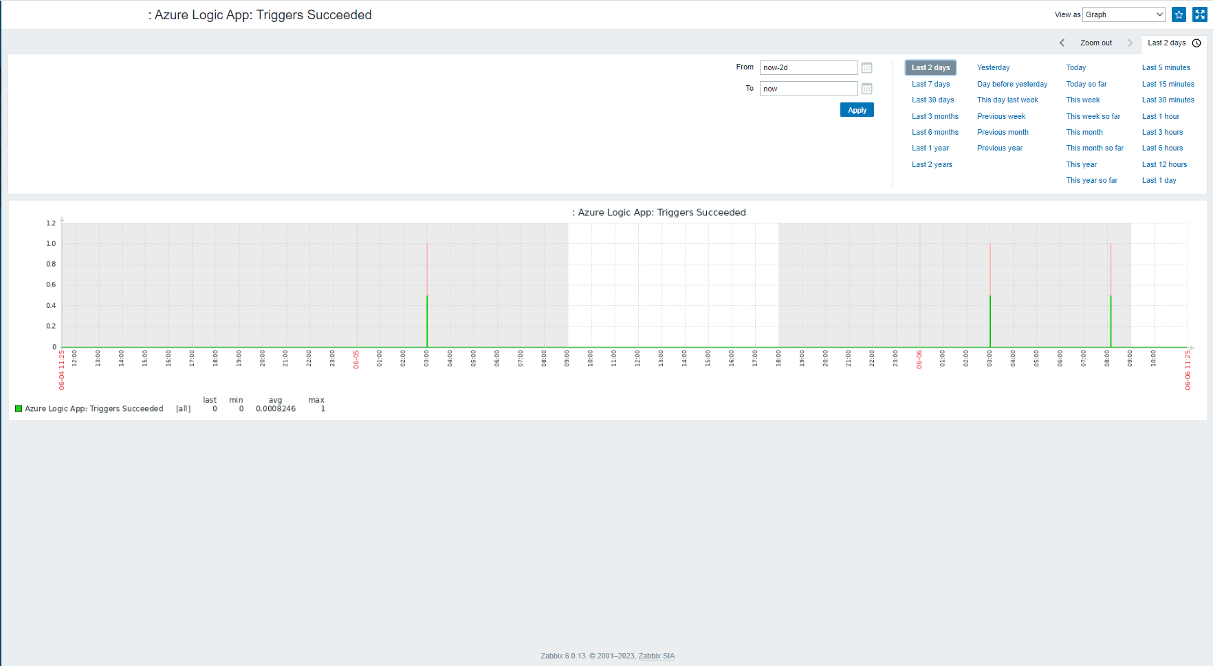

    Screenshot 2.0 - After decrease / zoom in the time frame:

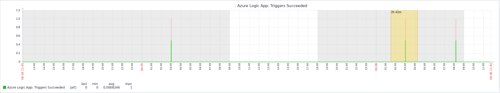

    Screenshot 3.0 - Result:

    • 4970
    You have too many datapoints to show each and every one on the 2d graph. IIRC, zabbix uses trends data to draw long period graphs. This means you will get min/max/avg values on graph.

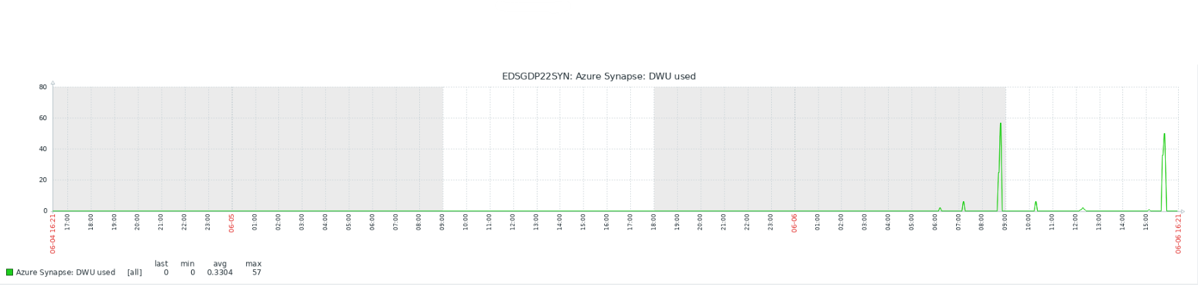

      Thank you cyber for your response.
      But what about the others, which we can still see the same datapoint even after decreasing the timeframe?
      Screenshot 1 - Time frame set as 2 days.

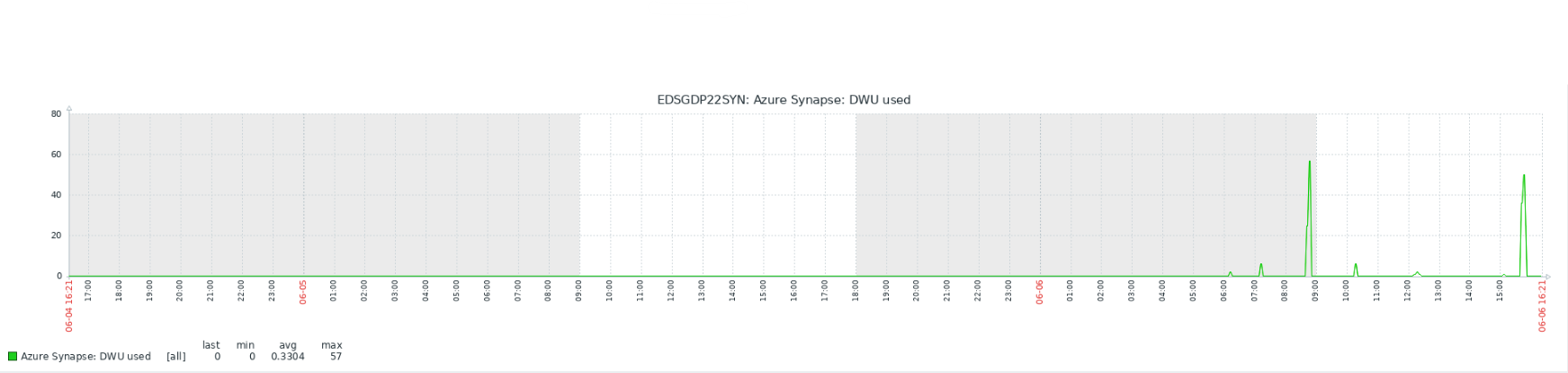

      Screenshot 2 - Decrease timeframe to zoom in graph

        • 4970
        Maybe just few enough datapoints to draw out all of them? Checked with longer interval? 10m maybe? 6 per hour, 144 per day? you have enough pixels on graph to draw out 2 days..
