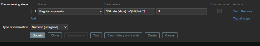

          I have tried but I am getting this error message

            • 4961
            I think you copied it all... with ""-s ? leave ""-s out, it should match.
              This is how I have it set up. and its throwing this output
              • cannot perform regular expression "^Bit rate (kbps) :\s*(\d+)\s+.*$" match for value of type "string": pattern does not match
                • 4961
                I think there is a little mistake.. ()-s should be escaped or they will be taken as capture group
                Try with "^Bit rate \(kbps\) :\s*(\d+)\s+.*$"

                  Thanks for all the help so far but its still spitting out and I have never used regex before.
                  • cannot perform regular expression "^Bit rate \(kbps\) :\s*(\d+)\s+.*$" match for value of type "string": pattern does not match
                  Maybe I am missing something. I can monitor from OID strings and I've figured out custom alerting triggers and dashboards but I cant seem to get this to work. This is sort of a new job responsibility of mine and I have a Zabbix trainer coming here to train me in the next few months but in the mean time I am trying to do things on my own and.
