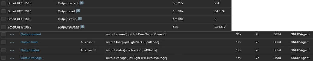

    Hi, i'am querying various systems such as switches, servers, and UPS with my Zabbix server.
    After setting up the dashboard for the UPS, I noticed that the polling interval is not being followed as shown in the settings/templates.
    If you look at the output current, you can see a defined interval of 30 seconds, but it still doesn't execute after 5.27 minutes.
    This delay can even extend up to an hour. It only sporadically queries certain values.
    Four servers that are queried via ILO SNMP also regularly experience issues where the host is apparently unreachable.
    This is clearly evident in the logs, but the cause is unknown to me. I have already increased all configurable pollers, but without success.
    All Systems are connected to Zabbix via SNMPv3.
