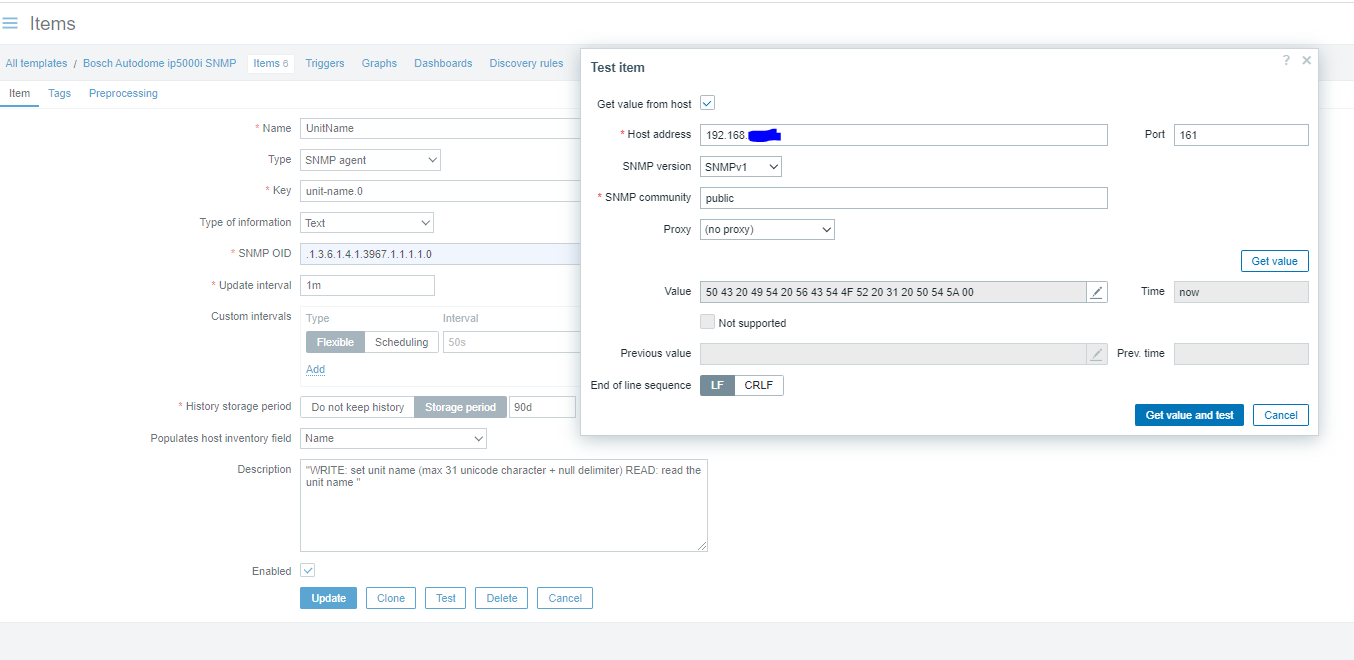

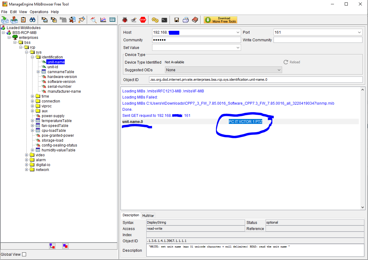

    Zabbix ver.6.4 Creating a new template for camera Bosch Autodome ip5000i. Faced with issue. Making SNMP request using MIB browser to get the unit-name, receiving the correct answer (PC IT VCTOR 1 PTZ), all is good. When i added this information( SNMP OID, Key ) to the new template and pressed Test button, I received incorrect answer in a very strange format (50 43 20 49 54 20 56 43 54 4F 52 20 31 20 50 54 5A 00 ). Others OIDs works correct, the problem only with this OID. Who had the same issue, how to solve it? Type of information tested as Text, as Numeric etc... The answer is the same.
    Answer is correct, "PC IT VCTOR 1 PTZ", but It is in HEX format..
