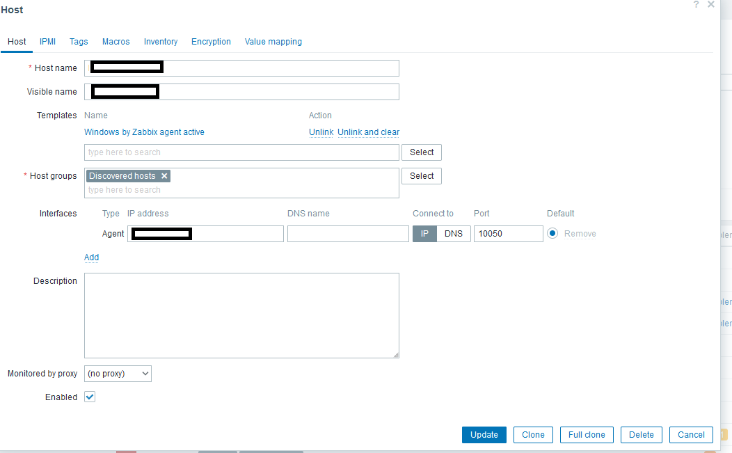

    I need to monitor Eventlog in windows for event ID 2102 ( Event Viewer: "Application and Services Logs>Microsoft>Windows>DriverFrameworks-UserMode> "Operational), and if a new event for eventID 2102 hasn't been generated in before 7 days, trigger.
    how can I go about making both a item to monitor, and trigger to send alert??
    I've already tried adding the item to the Windows by Zabbix agent template, and then tested disconnecting. I see an eventviewer log created, but Zabbix doesn't see it with the settings in the attached images below. Anyone have an idea??
