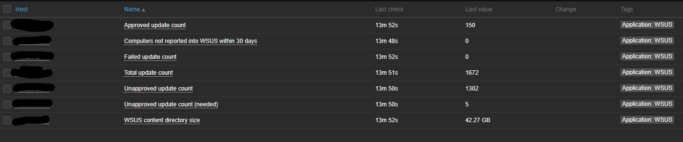

    • galavichid
      • Mar 2021
      • 45
      Simpler then I thought.
      Download the whole git code, unzip to: C:\Program Files\Zabbix Agent\WSUSReports
      Run with powershell Install-WsusZabbixTraps.ps1, you will be asked for the Zabbix Server IP.
      The file will create the tasks in the task scheduler for gathering the data.
      Add the Template WSUS Server.xml to your Zabbix templates, attach the template to your WSUS Server:​Click image for larger version

          • galavichid
            galavichid commented
            Add UserParmeter:
            UserParameter=wsus.updatestatus[*],powershell -NoProfile -NoLogo -File "%ProgramFiles%\Zabbix Agent 2\WSUSREPORTS\Get-WsusUpdateInstallationStatus.ps1" $1 $2 $3
            Unzip WSUSReoprt in C:\Program Files\Zabbix Agent\WSUSReports
            Run Install-WsusZabbixTraps.ps1 with the Zabbix Server\Proxy IP
            *Check carefully the paths in the .ps1 files directed correctly to your agent folder
