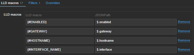

    Hi everyone.
    I have created hosts with the discovery process.
    The discovery process processes a JSON file. From this processing I get some macros that contain values that I would like
    to end up in the Inventory section (eg Hostname, Interface).
    I don't understand how to do it. Do you have a suggestion?
    Thank you

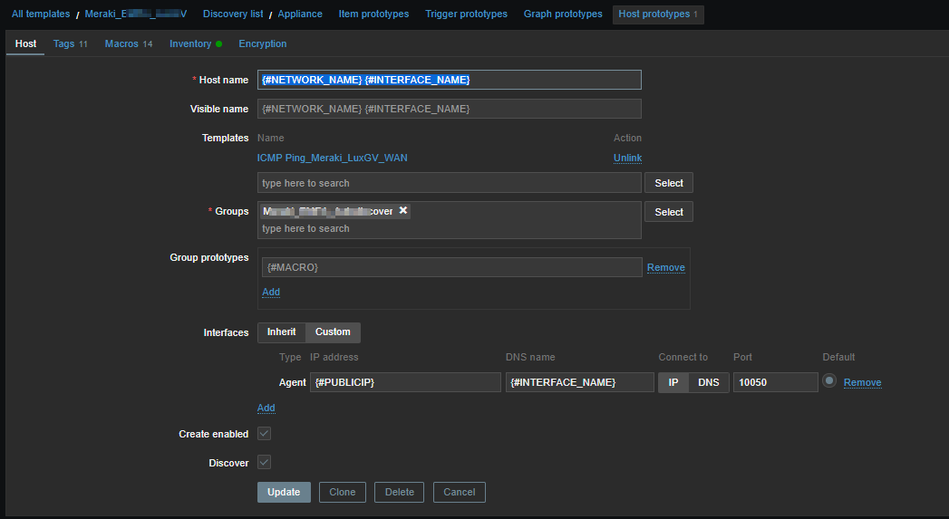

          This is the my Host Prototype​
