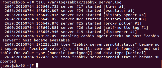

          If no data is collected using Item, you should have some information in the right side (like attached)
          Please attach log file of Zabbix server. If installed on CentOS from Packages should be located in /var/log/zabbix/zabbix_server.log
          Thank you!
          Br, Alexander

                              #15
                              server log
                              error reason for "server.unionvfx.local:arnold.status" changed: Received value [11] is not suitable for value type [Numeric (unsigned)] and data type [Decimal]
                              120924:20160704:163114.818 error reason for "server.unionvfx.local:arnold.status" changed: Received value [10] is not suitable for value type [Numeric (unsigned)] and data type [Decimal]
