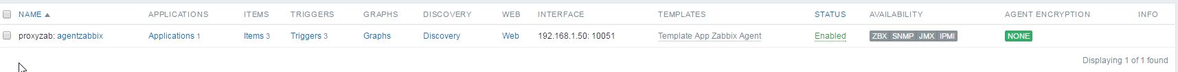

              I have this on my server zabbix (attachment)
              interface is the proxy (192.168.1.50:10051) , is it right ?
              regards.
