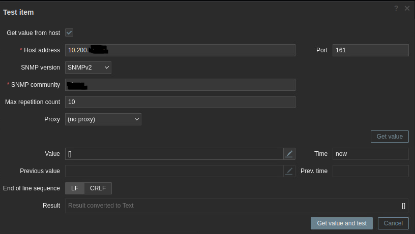

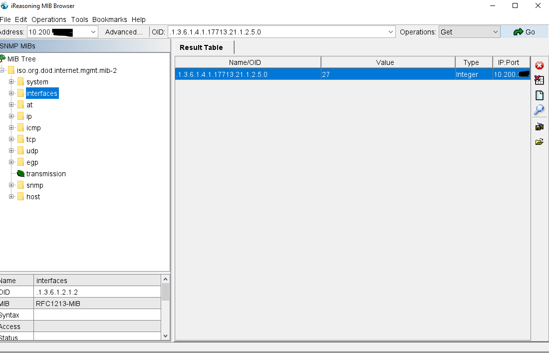

      Hello!
      Thank you for the speedy response, I'm going to attach some pictures. However, to explain, I'm trying to get the TX power from a cambium device using the OID of .1.3.6.1.4.1.17713.21.1.2.5.0, when I use a MIB browser outside of Zabbix to get the number associated with it gives a response of 27 which is expected. However, when I get the same OID from the same Device the test is giving me a value of 0. If you have any more requests I'm happy to help.
      From directly as an item on a device
ID:	467020Click image for larger version
      From a discovery rule on a template
ID:	467022Click image for larger version
      From my MIB Browser

        First of all - forget about discovery. That feature needed if you have multiple entities in your box and you dont want manually define them all and isntead want to automatically iterate through them. As an example: having multiple interfaces on switch, Why to manually enter all 48, if you can define automatation(discovery) and just configure one and let Zabbix to detect all 48 and apply similar config to each of them.
        If you just want to monitor single OID - SNMP Agent item is way to go. In regards to why it might not work - try removing leading dot from OID when entering it in Zabbix. So instead of .1.3.6.1.4.1.17713.21.1.2.5.0 just put 1.3.6.1.4.1.17713.21.1.2.5.0
        Do advise if it still not working after.
