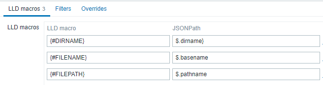

    As extra information the current setup in the 6.4.4, until written otherwise the mentioned steps are working:
    Click image for larger version  Name:	image.png Views:	0 Size:	5.8 KB ID:	467040​
    Click image for larger version  Name:	image.png Views:	0 Size:	13.0 KB ID:	467041
    Click image for larger version  Name:	image.png Views:	0 Size:	9.2 KB ID:	467042​​
    ^^ i fixed the } bracket of the dirname macro
    (above is part of the LLD get files)
    Click image for larger version  Name:	image.png Views:	0 Size:	10.5 KB ID:	467043​
    Both working and in the collect data the data I want to collect is shown in latest data.
    Only the part I want to do know is from that collected data create Items (the data is converted to json like mentioned in the start post)
    I can do (@ item prototype) select dependent item > select prototype == Collect data {#FILENAME} but then I'm missing macro's to create items based on the syslog file.

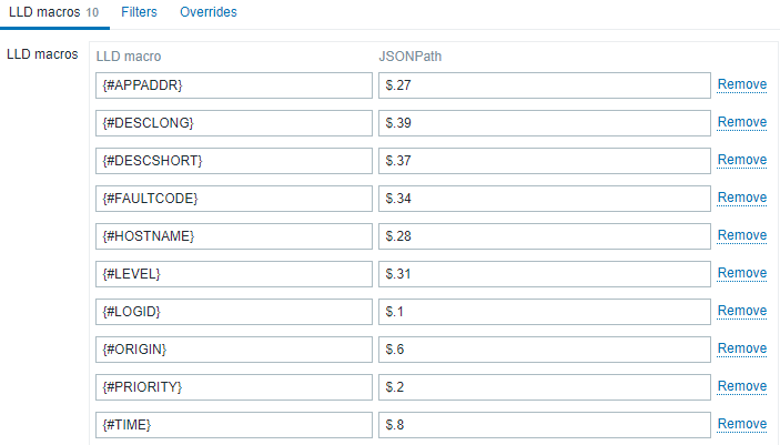

        Ok I try to summarize it better:
        First we have a syslog output of a device which report all kinds of information of other device. This could be 10 devices, could be 100.
        Only a few of those devices have static IP's, others have a fixed hostname (which can't be edited) I have identified the important field and {#ORIGIN} is always the device which reported the fault to the syslog device and based on the name/IP there I would like to create an Item.
        When an error occurs the LOGID of the fault is unique and the clear event (Clear / error / critical are based on {#LEVEL} ) has the same LOGID.
        So the combination of ORIGIN-LOGID ($.6-$.1)should be a unique key and LEVEL is the indicator if it's an active alert or clear.
        After preprocessing and as last step CVS to json the output of messages.log is: (I could replace the original : to different character before doing csv to json but that is not the example output, pre-processing already drops about 2/3 of all messages)
        [{"1":"LogId:3XoeCeGQAA","2":"Priority:",
        "3":"Origin","4":"","5":"CallId:","6":"address:10.1.1.20",
        "7":"UsrId:","8":"Time:2023-07-11 09.34.07","9":"","10":"Receiver:1","11":"",
        "12":"Cald:","13":"address:10.1.1.25","14":"UserId:",
        "15":"Time:2023-07-11 09.34.07","16":"Status:200","17":"","18":"Receiver:1",
        "19":"","20":"CallId:","21":"address:10.1.1.25/error","22":"UserId:",
        "23":"Time:2023-07-11 09.34.07","24":"Status:200","25":"","26":":",
        "27":"Application:\"MOD:[email protected]\"","28":"Hostname: ",
        "29":"name:Zabbix 1","30":":","31":"Level:0","32":"Pers:yes",
        "33":"Description:No error","34":"Fault code:300","35":":","36":":",
        "37":":","38":":","39":"detailed info: ","40":""}]​
        The reason for doing it dynamic (or at least try ) is that system can grow/ units can be replace etc. And I'm willing to setup it up completely different but I'm lacking knowledge on how to do it.

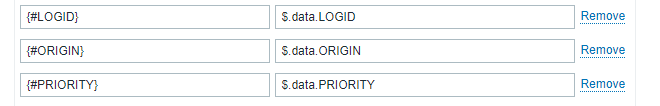

          The state I'm now at is:
          In a template I have an item which collect / processes the syslog data . Output is like following:
          2023-07-13 17:29:55 {"data":{"LOGID":"3XoeCfuggf+ySZiTQAA","PRIORIT Y": "","ORIGIN":"10.30.177.120/SystemSurvey","TIME":"2023-07-13 16.29.54","APPADDR":"10.30.177.89","HOSTNAME":" ","LEVEL":"0","FAULTCODE":"0-0-0","DESCSHORT":"","DESCLONG":" "}}
          2023-07-13 17:29:41 {"data":{"LOGID":"3XoeCfuggf+ySZcTQAA","PRIORIT Y": "","ORIGIN":"10.30.177.120/SystemSurvey","TIME":"2023-07-13 16.29.41","APPADDR":"10.30.177.89","HOSTNAME":" ","LEVEL":"4","FAULTCODE":"3-3-19","DESCSHORT":"IP equipment lost","DESCLONG":""}}
          2023-07-13 16:44:45 {"data":{"LOGID":"3XoeCfuggf+ySacTAAA","PRIORIT Y": "","ORIGIN":"10.30.177.120/SystemSurvey","TIME":"2023-07-13 15.44.44","APPADDR":"10.30.177.89","HOSTNAME":" ","LEVEL":"0","FAULTCODE":"0-0-0","DESCSHORT":"","DESCLONG":" "}}
          2023-07-13 16:41:48 {"data":{"LOGID":"3XoeCfuggf+ySaMTAAA","PRIORIT Y": "","ORIGIN":"10.30.177.120/SystemSurvey","TIME":"2023-07-13 15.41.48","APPADDR":"10.30.177.89","HOSTNAME":" ","LEVEL":"4","FAULTCODE":"3-3-19","DESCSHORT":"IP equipment lost","DESCLONG":""}}
          ​^^ about is twice the same alarm and clear, the logID is an unique identifier, APPADDR is the item I would like to create with the discovery rule.
          The discovery rule > dependent ITEM on the one which output the above text, key syslog and the same MACROs as in the first post. However the Jsonpath a bit different.

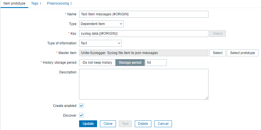

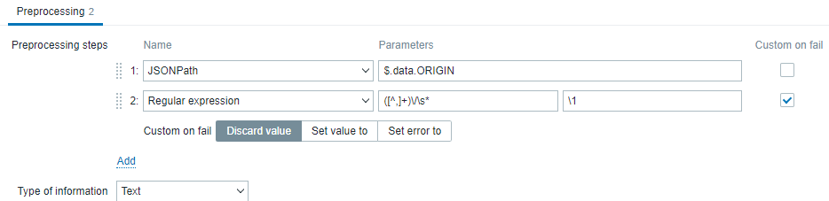

          Item Prototype:
          Click image for larger version  Name:	image.png Views:	0 Size:	24.8 KB ID:	467216
          Click image for larger version  Name:	image.png Views:	0 Size:	14.0 KB ID:	467217​
          However I still don't get any Item. When i test the preprocessing steps with the JSON output above I do get the IP adress without /SystemSurvey​
