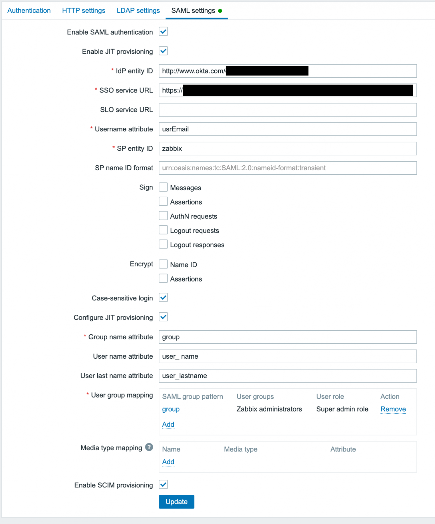

    Attempting to configure SAML for our zabbix web that sits behind a network loadbalancer.
    When attempting to access https://<zabbix_url>/api_scim.php?acs
    I'm seeing the following message: {"schemas":["urn:ietfarams:scim:api:messages:2.0:Error"],"detail":"The requested endpoint is not supported.","status":501}
    Here is the configuration for our SAML settings.

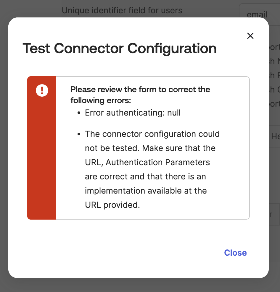

    When attempting to establish connection with okta through a test with an API token with super admin permissions we're getting this error.
    Can anyone help me identify as to what may be causing this 501 error?
