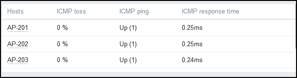

              See below SS. Use item as /ICMP ping/ in Group which you want to monitor.

                      Yes, you can use Data overview
                      in dashboard of Zabbix. You will the device status like this

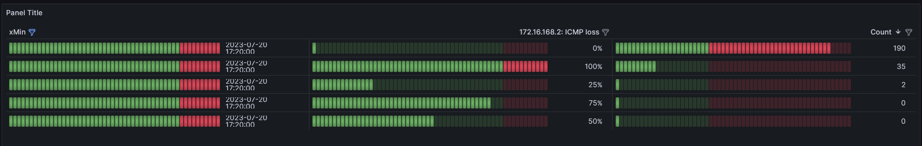

                              #15
                              I have devices in a group - Med Devices - which I only monitor via ICMP. The three metrics I get are ICMP Ping (giving up and down), ICMP Loss - giving a percentage, and ICMP Response Time. I'm thinking ICMP Loss gives the best info for this.
                              So I'd use 75%+ ICMP Loss for Unavailable. Anything under for Available. I can't think when unknown would trigger, but I'd want total as well.
                              And that's it for this counter.... I'm currently getting this from a table, but the problem is it needs to be tied to a specific time to be usable at all..(I have since worked out how to hide columns)
                              I'd want to group (average) values from unique hosts per time period: so if I have 100 hosts which are pinged x times over y minutes I'd want 100 values for each ICMP Loss over that period, no matter how many times they were tested . The table currenlty gives a set of 5 results (as I'd expect) for each time period (I've filtered to last measure on the above). I used transform to heatmap to get the above with buckets of 5m x, and 25(%) y.
                              It's getting there, but is clumsy so far...
