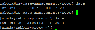

        Also, I noticed the times seems to be out between the proxy and host.. but doing a manually date on both indicates they're the same.

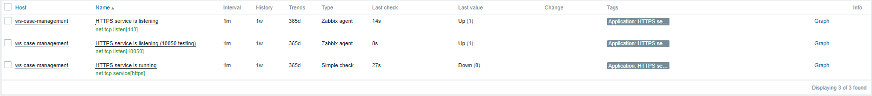

          Hamardaban​ and Atsushi thank for you for responses. Changing the item type to Zabbix agent fixed the issue for me. The root cause was I had cloned the Template App HTTPS Service template and simply (pun intended) changed net.tcp.service to net.tcp.listening. Completely my mistake.
          Click image for larger version  Name:	image.png Views:	0 Size:	25.8 KB ID:	467529
          Thank you soo much for taking the time to reply and help me.
