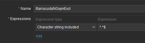

    There is a filter on this rule: {#SNMPINDEX} matches @BarracudaNGvpnExcl // @BarracudaNGvpnExcl Character string included ^.*$

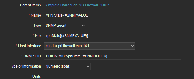

    The only item prototyp:

    Okay! After a solid 8 hours or troubleshooting, I decided to disable the filter once and it actually fixed it...
